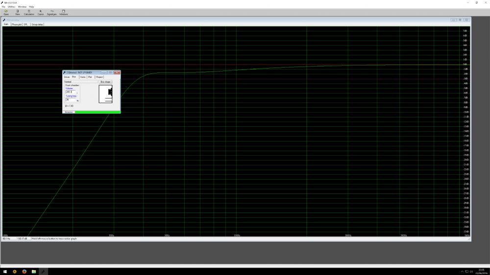

I put it into WinISD and tried it with two RCF LF18X451 drivers in a G Sub, I adjusted the port width to 102mm instead of the 120mm width on the original G Sub plans and aport length of 221mm instead of the 193mm of the original G Sub plans. This below is the frequency response it gave me, box tuning 35hz and is -3db down at 38.5hz.

Oh and the spl output with 3,600 watts continuous put into the sub with the two drivers is 132db at 37hz.

Look at your port velocity.

I've tried and can't get the velocity much lower than that at all. Couldn't I just add a bit more to the internal volume of the enclosure that way I could increase the port size. I worked out as standard the G Sub has an internal volume of about 265.3 litres.

Those results aren't great in terms of SPL or cutoff frequency to be honest.
