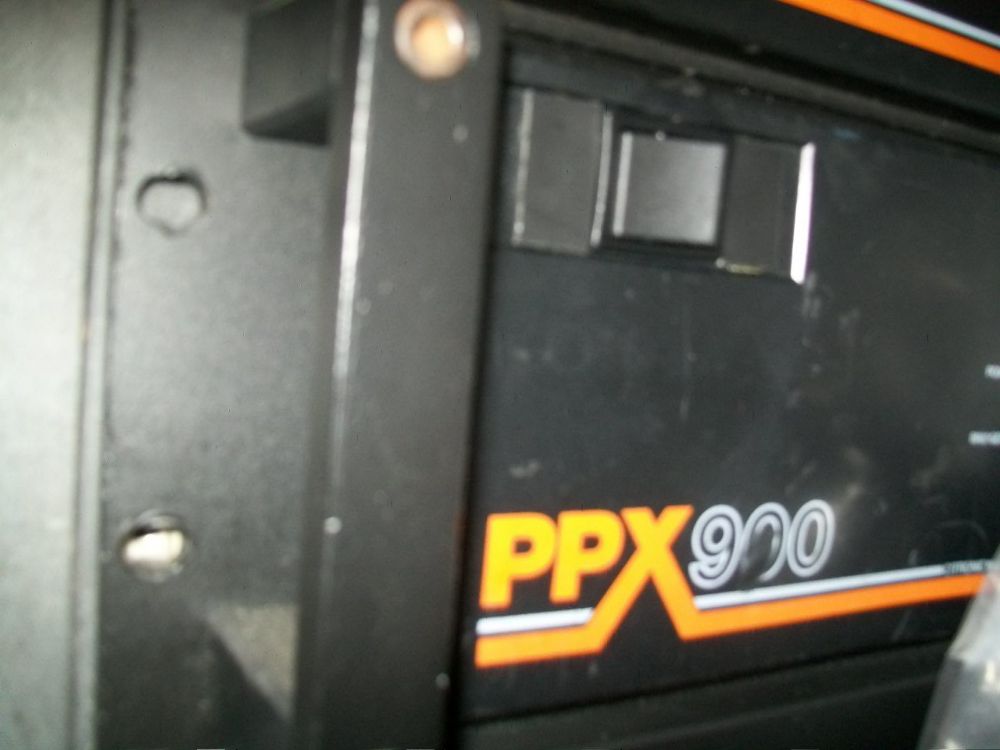

I have an early ppx900 that is in need of a new switch. I don't suppose you know of a source?

The early type switches I believe were custom made for the PPX and have not been available for a long time. I think you can still get hold of the front panel conversion which then takes the later type switch.

Early Arrow switch suffers from a little bit of plastic that wears internally,so the contacts do not make a firm contact,arc,and then burn. They can melt completely. As stated,a conversion to the later rocker switch is still avilable,but the panels they supply are unpainted,so you will loose the graphics on that panel.
I did a modification of the original panel on one,and fitted a standard 22mm rocker. It is possible,if a little time consuming.
