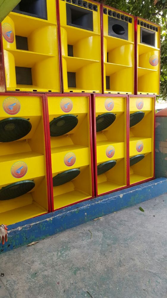

Joined a couple groups on FB. I can't believe how 9 out of 10 yard sounds have exactly the same setup. Selenium type mid tops with a line of bullets in them, stacked on top either 'canadian' type double 18 minis or double ev T18 style cabs. I come across the odd scoop here or there and the occasional folded horn. https://ibb.co/eito27" rel="nofollow - https://ibb.co/eito27

When did scoops go out of fashion?
Not a BPH or folded horn to be seen......
I don't get it.

Found a couple scoop stacks, not sure if they were from yard though.....

Yep. All of the current boxes are variations on Canadian/ Mini Scoop. Definitely an improvement over the T 18.

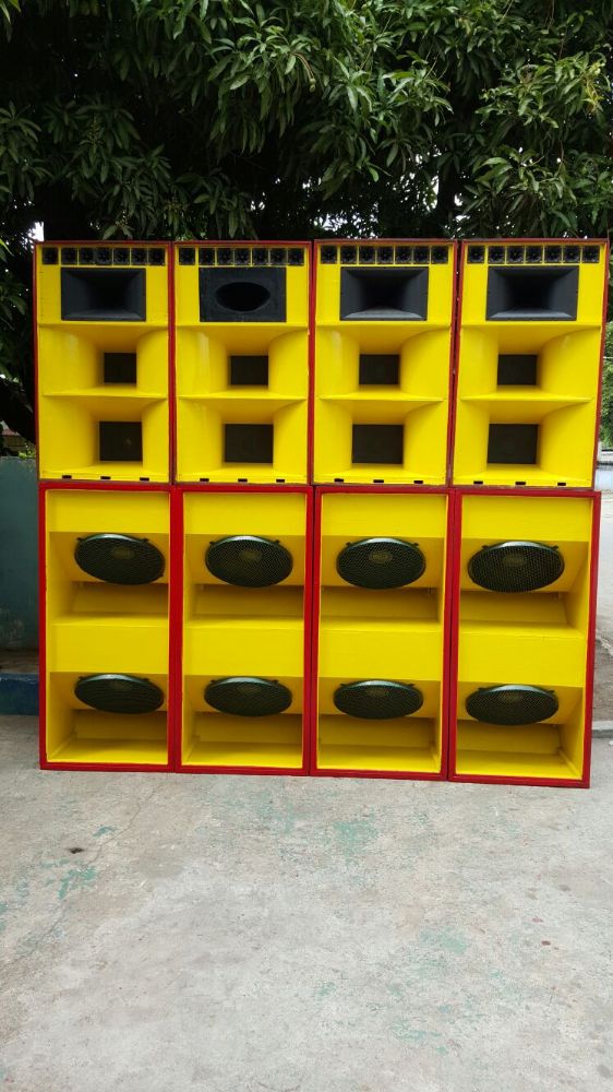

I always wondered where does the trend of putting mediums above the HF range, and / or compression drivers above tweeters come from?
Usually in the rest of the world the point source are stacked from low to high frequency, bottom to top I guess this is due to better copling of the drivers if they're close to one another.

If they expect the audience to be very close to the stacks then HF at the very top could go over people's heads. Moving the HF down to the middle of the cab solves that. Just one particular set of compromises they've chosen.

Thanks for the answer, are you sure they do it specifically for this purpose or is it your guess at it?
Not only the jamaican sound systems have the audience close to the stacks, we often do too.
In events I go in, when played at loud/war level usually you can still clearly hear the HF even if they're up your head and not tilted.
I really wouldn't want those compression drivers and tweeters straight in my ears Dead

My uncle once told me that the sound systems do it to keep noise inside the venue, thats the same reason why they use the t-18 type boxes so the bass fires down to the ground.
They believe if the horn and tweeters are in the middle the sound will not travel as far and there will be less police shut downs and complaints.
However these days most events have permits and only run till 2am so sounds are going back to the normal way of straight double 18 boxes and horn/tweeters high in the air

In no way do those T18 keep anything indoors. I have tons of experience of them and if you do some looking on PSW there is a guy who does stadiums (half time singers etc) with 12 of them in USA.
Having said that stacking them like they do does not work. In fact you may as well remove top row in my experience. Put the top ones upside down and in a block of four they chuck it as far as anything out there though. Nowt much below 50, unless eq is added in buckets,  had some a few years ago for nostalgia and that roll down sub in modern music is just plain missing.
Maybe we are all reading too much into the why, perhaps it's just fashion or hand me down advice?

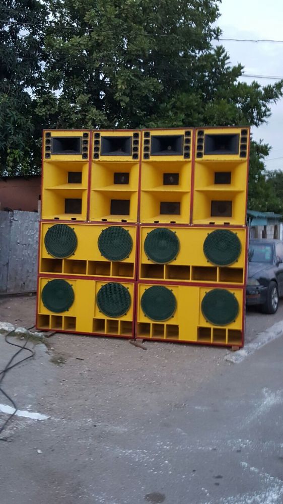

My brother in laws sound in Kingston

Morning Explicit! Can U advise the name of this sound & where it's located?

Hi Taurusty the sound is called Explicit from Waterhouse Kingston 11
