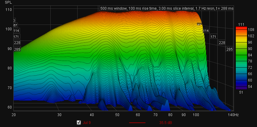

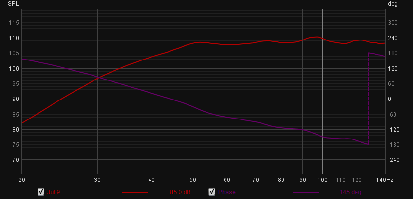

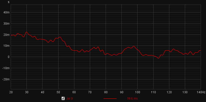

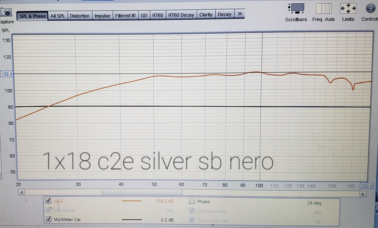

The odd thing about this is the report about the Silver Formula C-2E missing notes? That is not the nature of the Silver Formula C-2E so this calls the conditions into question ...... .    Instead of making the mistake of hyperfocusing on the cabinet itself we can ask about what may have gone awry with the conditions..
  The most current version of the SF C-2E (which Sinai has) measure well from about 30hz right on to where Huw would have needed to cross to his 2x12 tops, even without any smoothing added to the charts there is nothing missing and there are no issues in the time domain within that range either .....
Below is the measurement of a single cabinet outdoors, Halfspace (no smoothing applied .....  Driver isn't fully conditioned yet):

Looks fairly smooth, f3 of approx 45Hz and f10 approx 32Hz.
Any chance of some context re that measurement? Driver rated impedance, ground plane or 2 pi, distance of mic from cabinet, nearest boundary, drive voltage, rew calibrated to read accurate spl with chosen test equipment etc.

Test taken at ground plane. No boundaries within 50ft of test area. Driver is the Sb Audience Nero 18SW1100d with a DCR of 5.1 ohms. Amplifier used was a single channel from a Powersoft m50q and a Midas DM16 mixer. A bluetooth connection was established from a laptop. The mic used was a UMIK1 with authentic calibration files. Drive voltage was set to 2.83V using a fluke true rms mulitmeter (model 179) on pink noise. Mic placement was exactly 1M from the front edge of the cabinet with no offset.
Posted By: T Willy
Date Posted: 14 November 2022 at 10:01pm
And for anyone who's truly interested? id be willing to share anything from the mdat file that you would like to view.

"Drive voltage was set to 2.83V using a fluke true rms mulitmeter (model 179) on pink noise" thats weird why not just use a sine wave?
We can use whatever you want. But industry standard is pink or white noise that allows you to set the level consistently while playing all bands at once. Its an average of all frequencies. A sweep would be very difficult to set at exactly 2.83v unless you were using the peak/hold function. And we are not looking for a peak, but the average across all frequencies.

First of all, thanks for the detailed reply, any chance of sharing the mdat file?
If not could you show the FR with 5dB vertical spacing and 20-20KHz 1/48th smoothing and gated to first boundary reflection (approx 50mS).
Also the main part of the impulse response and the GD plot.
For future tests, measuring rms voltage using a sinewave may be more accurate as pink noise varies in output level, maybe not by much over the averaging time of your meter but I haven't tried it as my fluke 25 isn't true rms so I use a 50Hz sinewave.
Also, 1M is on the close side for such a large cab but at least it should be in the right ball park.
Re the difference between the impressions of the two systems, just one dodgy cable or miss configured xover filter could have messed things up for Huw's system.

Date Posted: 15 November 2022 at 1:23am
There is a lot to be said for implementation, and the Silver Formula C-2E (which Sinai i working with) is a good example of a Paraflex subwoofer with solid & well-behaved performance in the Time Domain ....
Here is the Group Delay:
Phase Response:
Waterfall chart:
As you can see there are no major anomalies, nasties or weirdness in the Time Domain .....    This is not a speculation or simulation, this is the real deal measured in the real world..

Group Delay plot:
8mS of GD at approx 95Hz and other ups and downs, GD wanders somewhat in the cabs passband compared to a reflex cab or there are boundary reflections interfering with the data, 20mS GD at the low corner is in line with a slow roll off in the FR.
Phase Response:
Looks like you have the impulse inverted.
Waterfall Chart:
Is all but useless for looking at the time domain as shown, rise time way too long and time range setting is way too long, try a rise time of 0.5 and a time range of 50mS or less, CSD mode and 1/48th smoothed. Better yet could you show it as a burst decay instead, 1/6th octave, 101 slices, 20 span periods.
