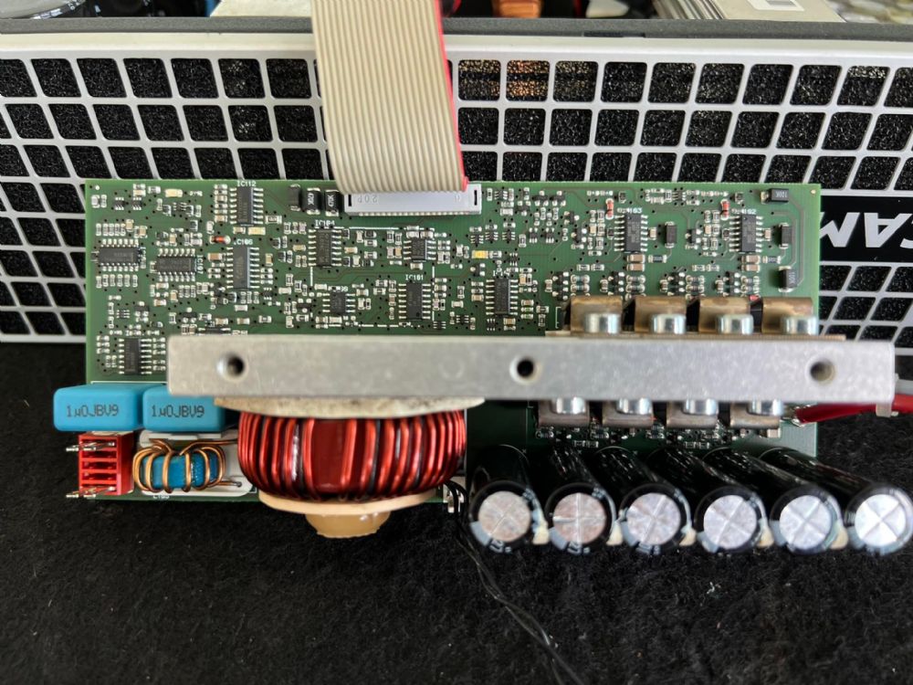

Anyone know anyone that can fix these, i have about 6x ch4 modules doing the Dc fault thing
or anyone know how to sort?
i have cleaned them, and tried in different LA8s
seems crazy to bin them all

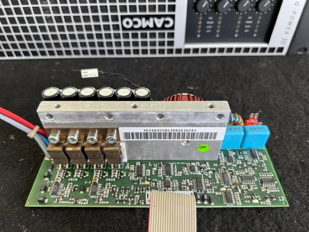

Arent those Pascal modules inside?

camco
North Staffordshire
Posted By: MarjanM
Date Posted: 30 May 2024 at 4:54pm
Originally posted by kedwardsleisure kedwardsleisure wrote:
camco
Camco used Pascal modules in their amps. That is why i ask is it Pascal inside.

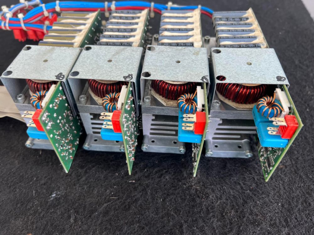

I've only ever seen camco boards in the LA8, each of the 4 modules are custom for the position in the amp, they are not interchangeable even in the same amp ie you cant swap say ch1 with ch4. They're somewhat better quality than pascal.

the only difference is the length of the cables
i have regulary put them in different postions when working out which were the ones were playing up on the shelf

L'Acoustics do a replacement kit for these modules, comes with new screws, tie bases, ties, rivets and instructions etc. There is also a returns form where you should fill out the failure circumstances of the old module, so I suspect they want them back as part of the deal.
But you must specify the channel number you need. The cables have to lie flat and true under each other and are all different lengths. You can't order a longer one and cut it down unless you're ok with IDC connectors and if it's too short it wont reach and the PCB transition header is soldered in making removal tricky.

i have already bought replacements, they are about £400 each.. and will soon be obsolete
hence having so many of them on the shelf.. always CH4 next to the fan
The ribbon cable is easily swapped from module to module, so if you have spare ch1, you could just swap the cable from the broken one and it'll no issues
