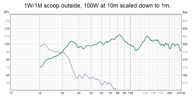

Originally posted by Sinai Sound Sinai Sound wrote:
Right then
Graphs
This is 4 x polar bear scoops measured outside
Single double 21"
The graph you based your slander on is actually not bad at all if it is half space, flat processing (except for hipass). It slopes gently down 5- 6 dB from 70 Hz to 35Hz. At 35 Hz there is a knee in the response, from there it drops another 4 dB going down to 30 Hz.
So it is 10 db down at 30 Hz. The sublows can be boosted within reason to make up for the apparent sensitivity loss, which is actually caused by increasing impedance, and less amplifier  power being dissipated in that range.
Stack of supers will be a lot worse.....
After all, how many times has it been discussed how two scoops of same external size will perform very differently, due to the chamber & throat tuning, expansiom rate etc........
I start to sound like Lev LOLLOL
Posted By: turbo7
Date Posted: 13 October 2024 at 7:48pm
Hi,
i dont slay any cabinet, all i am saying is that both designs are not more than 2dB apart, that is physics and everybody who questions that will have a hard time doing so.
There will be no complains for 4x V-18 super scoop or Polar + X, therefore i am not sure why to build double the amount of cabs, might depend on the wood prize..
Edit: The graph of the polar scoops shown in the link has a falling response from 50Hz down, that is a bad subwoofer response and is not desireable. No, one can not EQ much at 50Hz down, as it will raise powerdraw and excursion significantly.
A subwoofer response should look like the other way round as you want the energy down low not at 60Hz, just like the second graph that is shown in the link as well.
A large 18" Subwoofer should focus on the energy being in the 35Hz range not in the 60Hz range.
