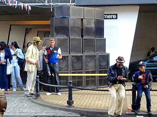

Here is video of 4x MT121s, accidentally covering approx 1000 people, outside.
Was supposed to be small 2012 Royal Jubilee Royal celebration, but as sub and tops could be heard miles away, Broadwater Farm, Tottenham was packed until midnight.
