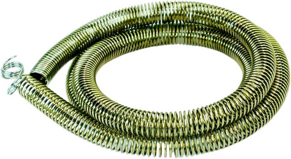

Yes. How many speakers are there that could actually handle 1000's of real watts for more than a couple of mS, if that? It's all become a joke.   Cry
This is a 2kW (heater) coil:--
These are speaker coils:--
Notice the difference?
I can't wait for the wonderfull day when Pro Audio finally returns to reality. I image not in my lifetime. Thank you car audio BS nonsense.    Stern Smile
