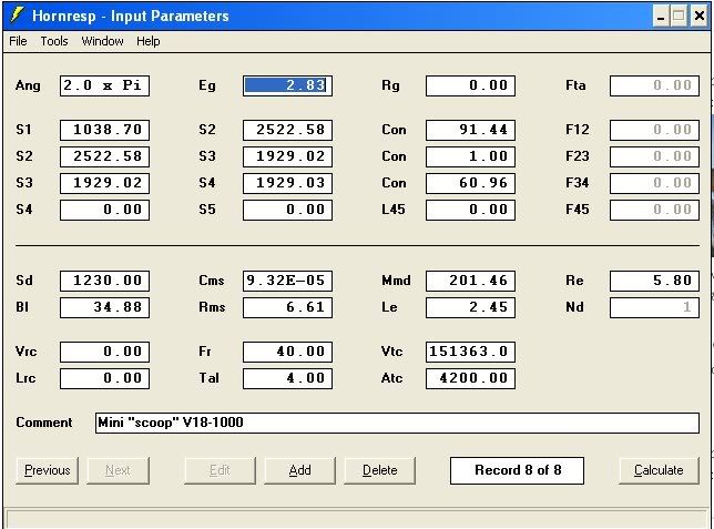

Looking at this, id say that the port is roughly 21/22" by 13/14"
So thats about 1925cm2
A circle of the same area would have a diameter of 49.5cm
the mouth is small where 2pi/wavelength*mouthsize < 1
Lets try it with 100Hz or 343cm:
 3.141 x 2 / 343 x 49.5 = 0.9065 = smaller than 1 = Mouth is too small to produce 100Hz = A PORT!

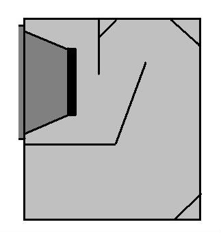

I assume this is what it looks like inside?
I have gathered this from looking at photos and stuff.
Can you confirm this tweet?

Posted By: Jake_Fielder
Date Posted: 27 March 2008 at 2:42pm
Thanks for that levyte, (who's that in the pic? shortman?)
Im pretty sure my crude drawing is right after seeing that pic.

Posted By: adambomb
Date Posted: 27 March 2008 at 3:04pm
I Think jake was pretty close.. but if you look at thos pics you can see a angled baffle... so I rackon its closer to this :
So... it has a throat.. and expension... so is kinda scoop like... I still reckon it works more like a long (low) ported reflex tho.
http://www.freespeakerplans.com" rel="nofollow - www.freespeakerplans.com
Date Posted: 27 March 2008 at 3:08pm
You are probably right, i wasnt sure if i was seeing a straight panel with a triangle piece or an angled panel.
Things i know for sure:
The two triangle bits on the right hand side are correct.
The throat is at the bottom of the chamber.
After the throat the "horn path" (port!) goes up to the top then to the bottom right, then exits through the port.

This is my minipoop design, it has the same outer dimentions as Smans, This is to scale:
Heres the HR input screen:
And heres the not so good output:
[edit: one of the pics had a swearword in the file name so it got filtered out!]
Date Posted: 27 March 2008 at 8:33pm
Dont have the specs....cant be arsed....already had v18-1000 on there....
Infact, entering drivers details into a computer annoys me SO MUCH that i think i might go to bed now.
I was going to model it as a reflex box with a long port in winisd but i dont have the full parameters and it annoys the living sh*t out of me trying to enter them! Angry
Does that drawing at the top look a bit more like it tweet?
Date Posted: 28 March 2008 at 7:56am
I'd really like to see actual design (i know that'll never happen!) because with the outer dimensions and all the information i have you cant get a sensible layout, theres always negative expansion somewhere and thats RIDICULOUS if its apparently a scoop.
Date Posted: 28 March 2008 at 11:17am
Behold the sacred box:
Date Posted: 28 March 2008 at 5:57pm
I still think theres negative expantion, i have just looked at some photos again.
The angled panel is too angled, and the left/bottom end of it is too close to the driver side of the cab, resulting in the space between the angled panel and back panel being bigger than the "mouth" or port = negative expansion.
(if anyone can understand that they deserve a medal!)
Date Posted: 28 March 2008 at 6:17pm
You misunderstand me, im saying that from looking at pics of unloaded minis, there must be negative expantion in the horn path,
Unless you mean back to the drawing board shortman, in which case i may have to agree.
Posted By: tweeter box
Date Posted: 28 March 2008 at 6:26pm
I can assure u there is no negative expansion, as ive seen em inside Wink
Why else do they thump soooo much!!
Heres a tip, put the ply behind the magnet at a slight angle Wink

nah, i was just pissing around. (i should probably change my post so people know that cheque thing is a joke)
I moddled it in hornresp and it was terrible! LOL
All i ment was the expantion rate looked better! one day when im rich and have spare time im going to build things like that and test them for real....
Date Posted: 22 April 2008 at 12:16pm
Originally posted by Mykey Mykey wrote:
it shouldn't even work
you could move a couple of panels in there and make an improvement straight away
Thats what im thinking, the port would be better with a constant area, and what is going on just after the throat? chamber 2 !?
