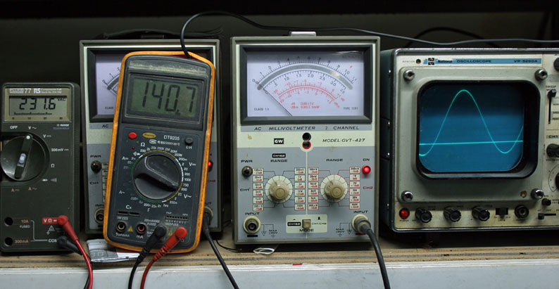

Date Posted: 22 July 2008 at 11:28pm
Originally posted by sKs01 sKs01 wrote:
even with a couple of farads of caps on the input, if your really ragging the amp an a heavy duty cycle they'll empty, if the psu doesn't support the power required youll loose power over time,
Example of an amp  performing to specs. Wink
http://speakerplans.com/forum/forum_posts.asp?TID=14937&PN=1 - http://speakerplans.com/forum/forum_posts.asp?TID=14937&PN=1
Originally posted by Rog Mogale Rog Mogale wrote:
Varoius frequencies were tested but both amps can put out the same from 20Hz up to 20KHz, so 50Hz sine wave was use for all testing.
Next the Infinite 7 v2 bridged into 4 ohms. It gave 140.7 volts which is 4713 watts or 2356 watts per channel. Again if the load was excatly 4 ohms the output would be 4949 watts or 2474 watts per channel. Its specs sheet says 2450 per channel into 2 ohms, so its doing better that its specs say.
Dont think we need to summon Inf8Mk2 for this, Inf 7 Mk2 should be good enough comparison. Sine wave or Dub Test.Wink

Originally posted by andyamp andyamp wrote:
Hi every one, the duty cycle (average)powere of audio when driven music into a loudspeaker is approxamatly 30% off rms power.
as music is made of dynamic information,it is true that the dynamic power is what matters.
However i get to see and test a lot of amplifiers.
the amps that can realy do rms power are the ones that do the biz.
There are not many of them.Question
any one is welcome to come here and have there amp tested.
providing they are prepaired for a disapointment in most cases.
Don't bother with bringing the FFA8 to me as It is the most powerful UK made amplifier out there.StarClap
I have held that position for 8 years untill the FFA8Star
if any one has a uk made amp that they recon can chalange my xp3k for the 2nd biggest uk amp please bring it to me for testing.
and post the test resaults.Cool
a 10amp slow blow fuse will take the full power when playing music as this sort of fuse will take peak's of about twice the continus current.
I am working on my next f-off big ampLOL
and maybe regain the No1 spot.
