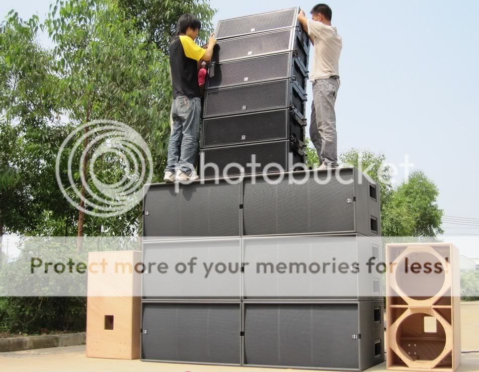

Posted By: Xmax extreme
Date Posted: 11 November 2009 at 9:45am
Build some of these...Smile
Maximum Excursion
Don't criticize your own competition, it looks like a publicity of your own commercial products.
Posted By: Saul
Date Posted: 11 November 2009 at 10:22am
wsx?
thats an impressive pile - martin stock room me thinks
Posted By: MusicXtra
Date Posted: 11 November 2009 at 10:39am
Bigger is not a synoniem for a better performance.....
A good design is when driver, cabinet and ports are optimised on each other. So it is possible to make a small cabinet with a great performance and vice versa.
Posted By: dj-panoramix
Date Posted: 11 November 2009 at 12:34pm
what are the kick bin just behind the wsx ?
Posted By: norty303
Date Posted: 11 November 2009 at 3:47pm
[QUOTE=dj-panoramix][
QUOTE]
Its' a dual 18Smile
21 inch.....
WSX in action
Maximum Excursion
Posted By: MarjanM
Date Posted: 11 November 2009 at 4:23pm
QUOTE]
Its' a dual 18Smile
21 inch.....
WSX in action
Who's pictures are those?
Do you work for Turbopower?
Date Posted: 11 November 2009 at 5:02pm
Nope mate, some friends of mine.... Smile
Maximum Excursion
