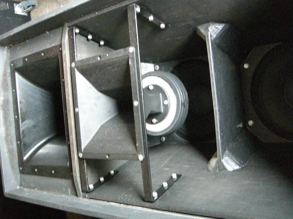

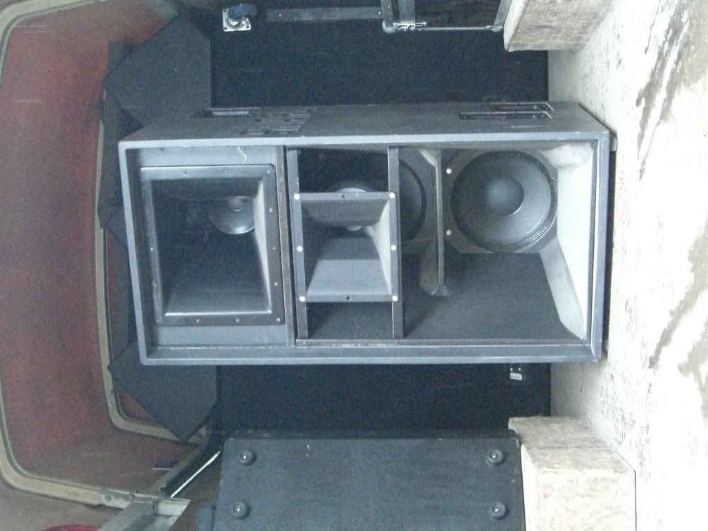

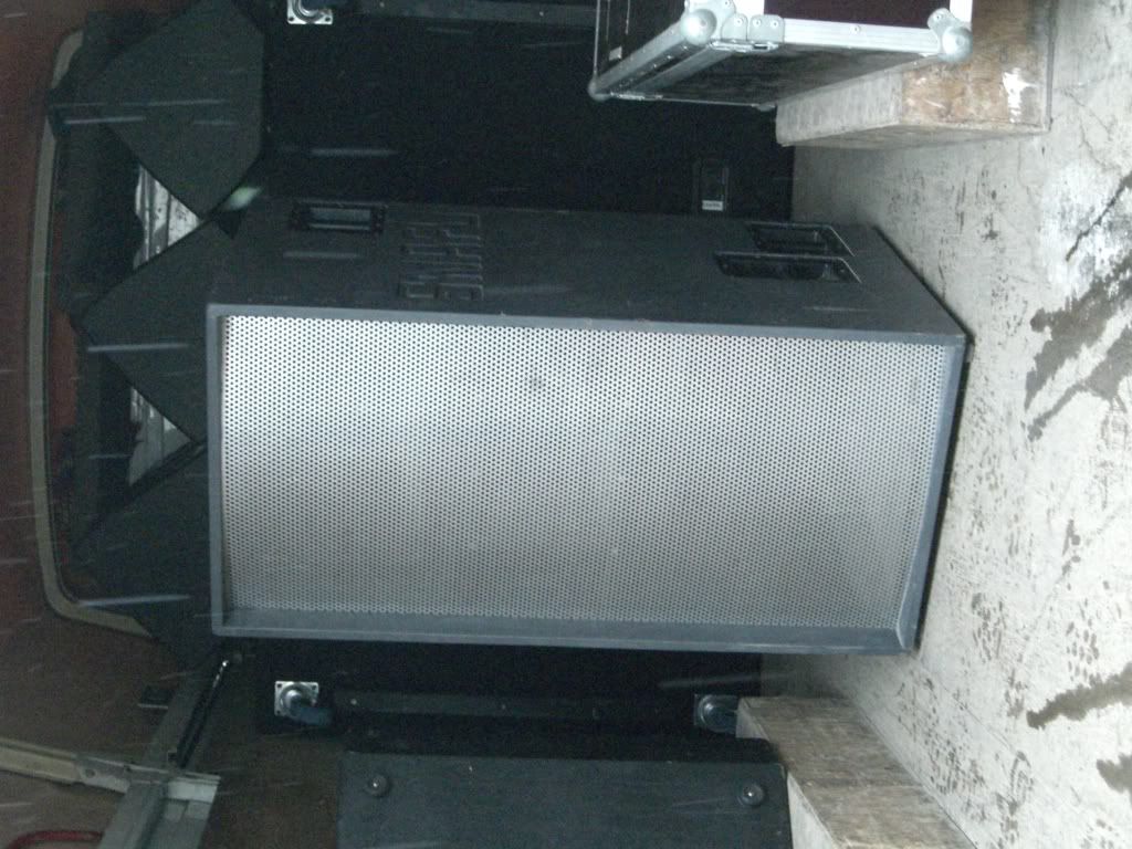

Posted By: snafu
Date Posted: 01 April 2009 at 1:25pm
Hi daveyt. I have been using the 8mr on a large fiberglass horn for the high mid in my concert mid hi,s 700-2.5hz with great results.Very cheap(20 quid)actively driven two to a side on chamelean dx600.very loud clean no failures in 6 years.
Posted By: mykey
Date Posted: 01 April 2009 at 2:55pm
snafu, can we see it?
the whole cab that is
......just all them hanging there like giant bananas.
Posted By: snafu
Date Posted: 02 April 2009 at 11:53am
Hi mikey.I have just got broadband so I will try to post pictures now.I may be some time.........

Posted By: MarjanM
Date Posted: 03 April 2009 at 11:41am
Those are really nice tops snafu. What are the other components? How do they perform?
Any gig pictures?
Posted By: snafu
Date Posted: 03 April 2009 at 2:33pm
Hi marjan.the drivers are 8mr eminence on high mid, cp650ti beyma mounted on B+C 60-40 horn on highs and the low mid is 2x12 beyma g250r.They go quite well(I think so)and they throw nice clean vocals out to the end of my multicore no problems.we saw 110-113db at the mixer(32m)last year when tested by health and safety federales.I would love to try 18 sound neo driver in mid but at £140 a go they would have to be stupendous to be better value than £20 8mr not sure if it,s worth it..
interesting looking cabs,have you taken any measurements?
 i would imagine a massive amount of diffraction and standing waves caused by your comp taking so much space, and uneeven loading on the two g250r's.
