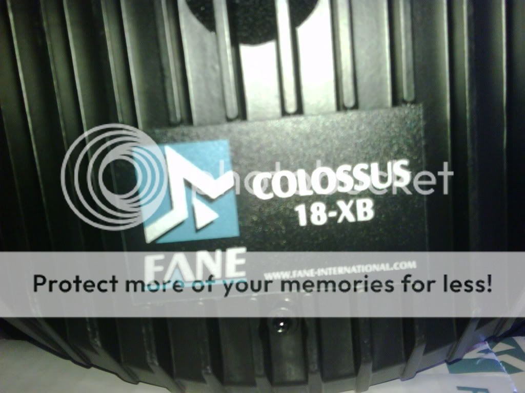

Posted By: RUS
Date Posted: 17 September 2009 at 2:35pm
hi.
this is what it says on the driver.
when i got my xb's a few years ago Embarrassed this is what it says on the side of the box.
