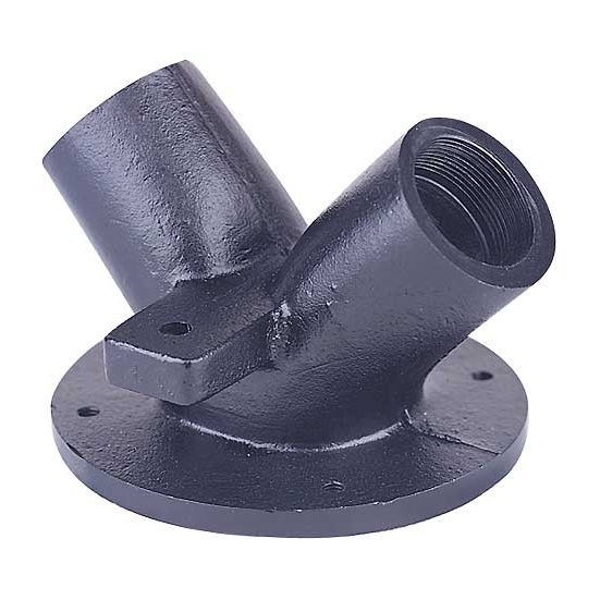

http://www.bluearan.co.uk/index.php?id=PAUPC80">Image of P.Audio PC80 2-way Adaptor
Largest image of P.Audio PC80 2-way Adaptor we have available
Click the image to go back to the description
Bolt two 1" screw-on drivers onto one 2" throat horn.
£24.59 inc VAT
(21.38 ex VAT)
