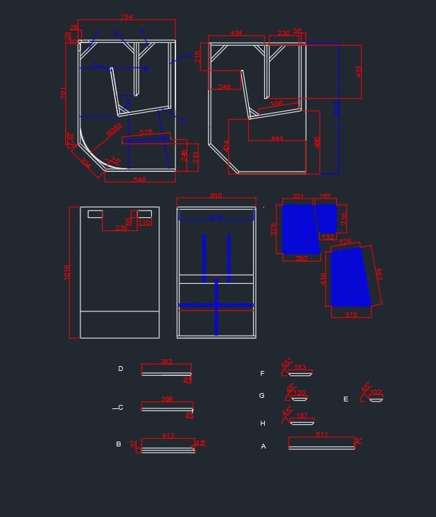

Hey good afternoon i am new to speaker plans but was readin for a wild Wink i hav learn alot from u guys then i was think to my self i need 2 rhino scoop. for a whild now i had 2 brand new seleium sws800 that i desided to get 2 rhino home for them so i email mykey to find out which one will work better an he said mk2.which was ok for me but when i cantact saul he told it will play better in mk3 so it tool me a wild to start to built. so wat i did is built mk2 cause i remember that mykey say its easy to convert mk2 to mk3 Wink

welcome to the scoop forum! as you seem to have already learnt, the most efficient way to get popular on there is to use the wink smiley thing.
and extra points are awarded for ignoring saul's advice, so good work!

extra points for being able to convert to mk3 by just adding a bit of 18mm into the chamber.
you'll soon see if it's the right version - if the driver is out of control, reduce the chamber size.

Posted By: Bremen_99
Date Posted: 26 February 2026 at 8:56pm
nah they are un-necessarily stingy with scoop designs for some reason. But I am trying to identify this miniscoop and I think it might be rhino, if anyone wants to clear that up
Date Posted: 27 February 2026 at 12:05am
I mean Im pretty sure what i posted is the mk2 staiper (ms18) mini scoop that a lot of people use now days. Modded might be approximation of rhino. I would maybe make it to be wider  but I am a novice in this area so really not the guy to ask or pm you, sorry, hopefully someone will see your request in due time, I wouldn't hold my breath though. I'd like rhino plans too Im curious to make like a 636mm wide Staiper MS-18. You should post them here if you find adequate plans, ill do the same . heres the medium scoops from facebook
Date Posted: 27 February 2026 at 8:46pm
Originally posted by BadmanSS BadmanSS wrote:
Look at Facebook reels/YouTube, and you will see free designs, mass produced in the East, do you think the designers are receiving any donations?
Looking at right sites, all the best free designs, are available.
Even my fav Mini Scoop plan.
do you want to confirm or deny shortman mini is just a mk1 ms18 modded wider? What is your favorite mini scoop design you speak of
Date Posted: 01 March 2026 at 8:08pm
iim pretty sure shortman mini is just this (mk1) that is 30" deep (deeper by 3 inches, some people in the scoop forum think thats a huge amount 😳 ) but its basically same design. The ms18 mk3 might be better more modern design than the shortman mini even. I think im going to go after tapped horns, insane sensitivity, but also linearity, and cooling. Better transients. Danley was one designer that actually knew what he was doing. The other best designer, Mogale, made his designs public, the shortman is a chopped down super .
