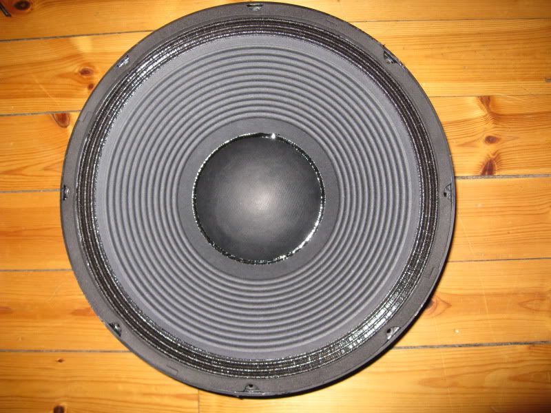

Hi there.
I have came across two "the box speaker 18-500/8-A" (Thomann.de)
Will they work in a G-sub?
This is the parameters that followed with the speaker.
Fms: 40,1Hz
Qms: 7,61
Qes: 0,45
Qts: 0,43
Res: 103,3ohm
Rms: 6,1kg/s
Cms: 0,09mm/N
Mms: 184,9gr
Nref: 2,86%
Bl: 23,8N/A
SPL: 96,6dB
Vas: 208,3l
Re: 5,5ohm
Rp: 84,1ohm
Lp: 49,0mH
Cp: 566,8microF
Le: 1,3mH
The driver costs 122euro. Should i just sell them and get the PD186 (255euro) or get to more of these and build two cabs?
I´m not out for the absolutly highest performing subs. Just for small events and mainly dancechart music. Got two tapco 6918 (single 18 reflex) and they are just a little to small for me.

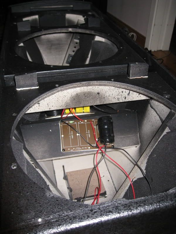

I built two boxes and tought that if these did not work i´d buy PD or Fane to put in. But now it looks like i will be ordering two more of these Smile
Now it´s only the fun part left with fixing handles, grill and paint. Big smile

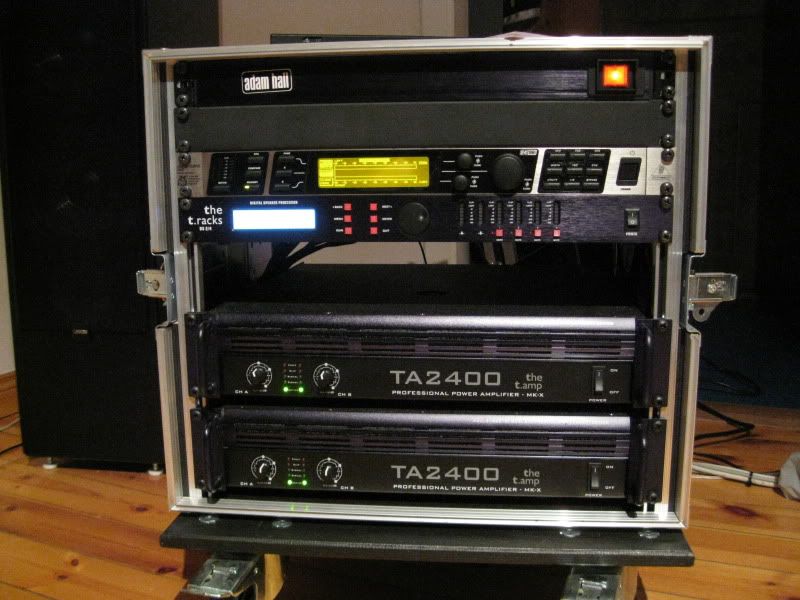

I now have two G-subs with theese drivers.. I feed them with one TA-2400 1200wrms per box.
But will they survive say a Proline 3000 @ 1500wrms per box?
Or should i stay with the smaller TA-2400 or should i go even bigger as the T.amp D3400 @ 1800wrms per box?
I know the D3400 is not a recomended amp. But lets keep the question simple! How big a amp should i have to get as much as i can out of my budget G-subs without burning them up the first night! Wink

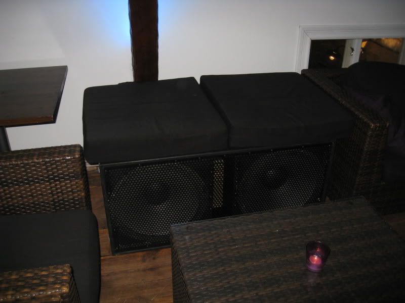

So i have had the rig out for the first time..
What can i say. Succes.. Sounded better and MORE than and had ever hoped for! :D
Everything is still ok even thou the dj kept driving the amps in to clip..
I'm very pleased when thinking about how little money i have spent! Thumbs Up

Keep in mind that it's a rs232 (com-port) connection. I got that old Ibm laptop saved for things like this..

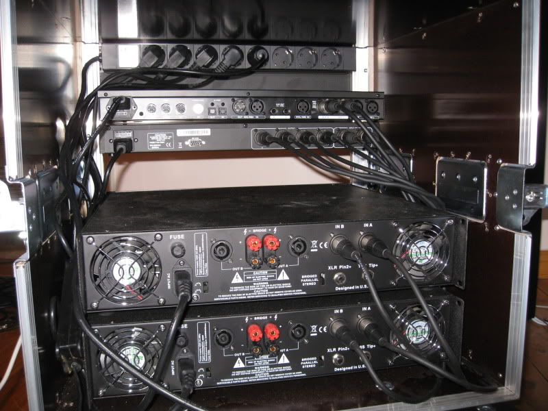

Updated my rack a little :)

Had my system out tonight at a small club.
Very small room and the sound was amazing. Since we were running on half throttle i lowered the hp on the G´s to 20hz. Everything was shaking Party
And they make a good couch aswell Wink

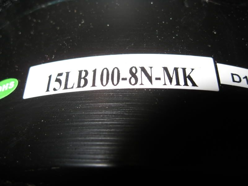

me and a mate are thinking about building some g-subs. would you recommend these drivers as were running on a budget or should we just save up and get others?
cheers
Posted By: Walle_W
Date Posted: 31 May 2011 at 10:32pm
DJ5milez: I have nothing to compare with..
They are from:
http://www.elderaudio.com/products/Loudspeakers/LFSpeaker/2009/18LB100-8BA.html" rel="nofollow - http://www.elderaudio.com/products/Loudspeakers/LFSpeaker/2009/18LB100-8BA.html
Posted By: Tony Wilkes
Date Posted: 01 June 2011 at 9:00am
They are from:
Gap Depth = 11mm
Voice coil winding length =11mm
err  XMax = 0.0mm
Bets that performs well.

Posted By: Walle_W
Date Posted: 15 August 2011 at 2:36pm
@tobvil. They are great for the money. Much better than the Tapco's i had before.
I got some pics at home with the drivers out. They look very well built. I will post them when i get home.
I love the handles on top/bottom, makes them very easy to carry between to people. But they are a pain to move around alone..
I use them alone on smaller events like weddings and they do just fine, to only problem is that you need something to put them on to get them high enough..
I cant't wait till i can afford to finnish my second pair of G-subs an replace the mk-x amps with prolines.
