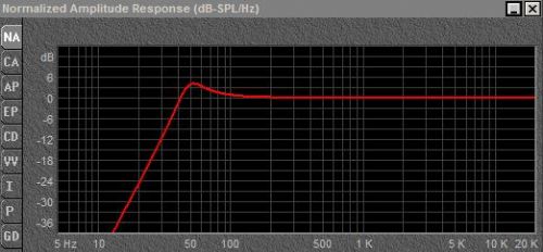

Looking good, any idea on the simulated response for the fane 18xb in this cab mate?
Posted By: Ali.T
Date Posted: 31 May 2011 at 5:29pm
not a clue pal, yet to test them :)
Posted By: Adam_Iron_Horse
Date Posted: 31 May 2011 at 5:32pm
A simulated response is made on a program called WinISD or HornResp Ali its how people design speakers.
:P
Posted By: Ali.T
Date Posted: 31 May 2011 at 5:36pm
meh, im down down with this whole malarky :)
Date Posted: 31 May 2011 at 6:11pm
had a quick go at simming it first attempt using bass box pro so dunno if i did it right...
