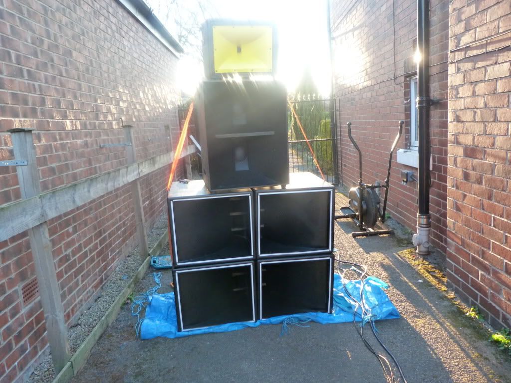

Posted By: nuclearbass
Date Posted: 09 January 2012 at 3:29pm
had the rig out on my garden for a quick test to find i have a druiver down... this is going to be the last pic i put up of the rig till ive built my new hds, and changed my colour scheme

Posted By: Strange Daze
Date Posted: 10 January 2012 at 10:46am
Looking GOOD!
Personally, I'd stack the Blue HDs, spalyed side-ways...with the black ones (also side-ways), on top, beneath Dan's old Omni-Tops (nice refurb on them by the way)..
That'd look tidy as fook, and give you (ever so slightly), better dispersion in my experience.
Date Posted: 10 January 2012 at 11:08am
Originally posted by Strange Daze Strange Daze wrote:
Looking GOOD!
so there 3 high?
would that sound better?
i havnt really tried different variations as yet, this was just a quick rig up and a play i had at home..
I didnt think it would make much difference to wich way the hds were stacked as long as all the mooths were togeva..
Any one else add any input to this?

Posted By: Tocooltom
Date Posted: 10 January 2012 at 1:20pm
If it was me i would i would stack them in 6 block, in 2 piles of 3
Date Posted: 10 January 2012 at 1:35pm
Originally posted by nuclearbass nuclearbass wrote:
so they're 3 high?
Yup.
In my experience?....yes...it will.
One problem you may come across is that the tops are a little high, so a bit of 1x1" wooden baton at the back of your tops, to angle them forward will be needed.
If you do this, you'll notice better projection of the tops, further back because of the height...but because of the tilt forward, they'll still cover in front of the speaker stacks.
If you do this: BE CAREFUL and make sure the tops are strapped down tight and safe!! Smile
See above. As well as the extra height to your tops, you'll still be getting the coupling with the floor, and a bit of extra dispersion.
When we had access to a pile of HDs (x12), we ran them this way occassionally...and found it better then the way you'd stacked them, which seemed to just result in a very narrow, forward firing ''power alley'' of bass.
Depends on what you want, I guess...
Good luck Smile

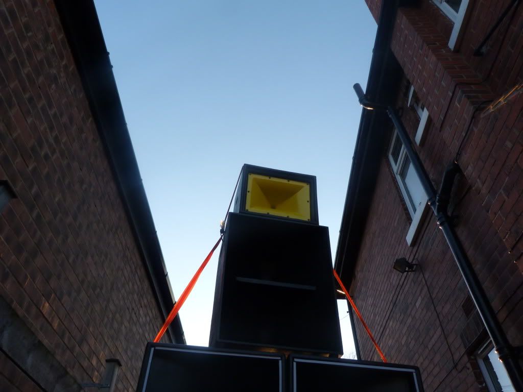

Date Posted: 18 March 2012 at 4:03pm
done a little more work on the rig, painted the hds, had the horns and tob boxes sprayed., gunna get a pic of the rack up this week
still a way to go yet, all the hds have yellow grills to be fitted and i have som eyellow paint to give the mids some personality :)
But yeh, im getting there, not bad for a 1 man band lol
