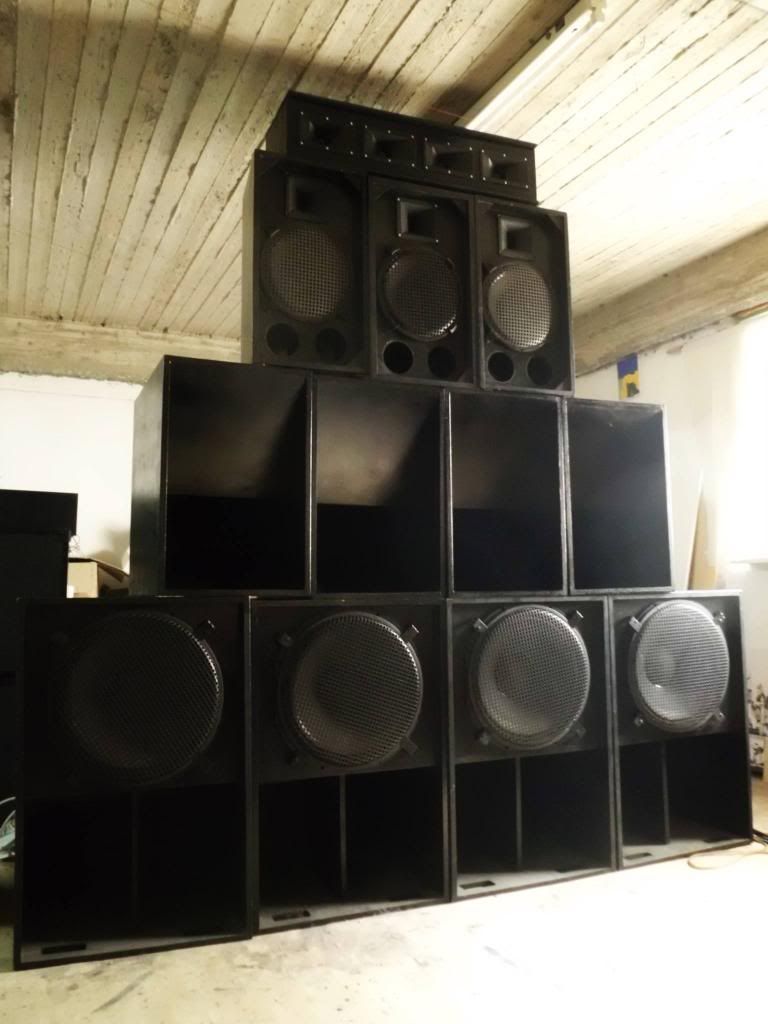

http://hornplans.free.fr/turbo_bph238.html
Which Turbosound plan is this a copy of?
Posted By: tweeter box
Date Posted: 14 December 2011 at 6:24pm
been looking for these, nice one Wink
PRECISION SOUND SYSTEM.
Posted By: luton_soundman
Date Posted: 14 December 2011 at 6:29pm
those 'kick bins' look nice tweet Tongue how much would you buy a pair unloaded for??

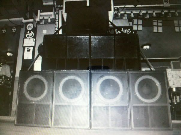

Originally posted by Sarf London Bass Sarf London Bass wrote:
Who's rig is that on the right? Those kick bins look much like these plans:
http://hornplans.free.fr/turbo_bph238.html" rel="nofollow - http://hornplans.free.fr/turbo_bph238.html
Is this design a Turbosound cab? Are they originals? What are they loaded with?
Ive searched the Turbosound product sheet and cannot find any designs that are anything like this cabConfused
I would appreciate it if someone could shed some light on this design because i am thinking of building some!Big smile
Posted By: cravings
Date Posted: 15 December 2011 at 5:39pm
what are you looking for?
basically these were made in the early days of turbosound. the festival rig was broken up and used for hires, the company were called Turbosound Rental in those days i think. cabs of this era were built by SSE in Nottingham. these bins among some of the other early stuff was made at that time. there's no data sheets for anything from this time. the TSE range as you found the data sheet for was a later range that evolved from this older stuff. look in the golden oldies section for a thread called "Turbosound: the relics" or something like that.
the tse range was early 80s so these are older than that. the bins pictured above could be originals or copies.. in either case, the bracing was added, that wasn't there originally.
copies are often better than originals of these, because they're newer. many of the old ones have got fairly rattly by now.
also.. the HD15 is basically the TSE-215, not the other way round heh
i have mine loaded with pd154, i play them above X1s, i run them up to 150hz.
in the turbosound data sheets you'll find many 18" bins based on this. arguably the ES18, the USB, the funktion one 18" bins all owe their arrangement to the old turbo bph. be they 18 or 15".

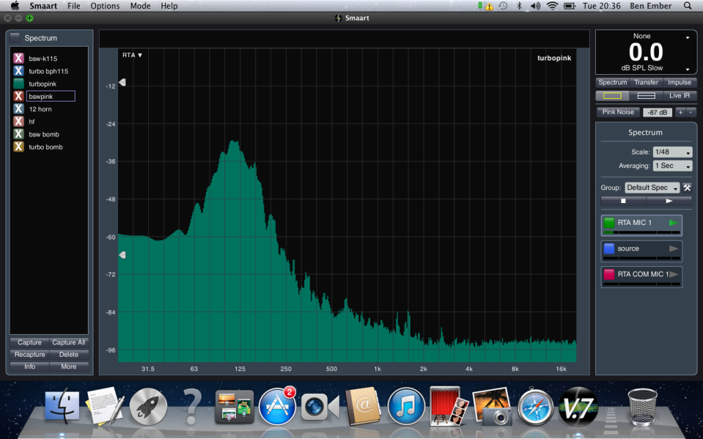

Theyre exact copies of the original Turbo bins, originally made by Minimaximal of the forum, sold to me then sold to Luton Soundman
Excellent on kick, thanks to your link to the plan im gonna be making single versions
ive A/B these with HD15 and tbh the HD15 didnt stand a chance, each cab was tested with PD154 & PD1550, please note that the 154 were sold straight after the test Wink
Freq played was "approx" 60hz-150hz, hope this helps Smile

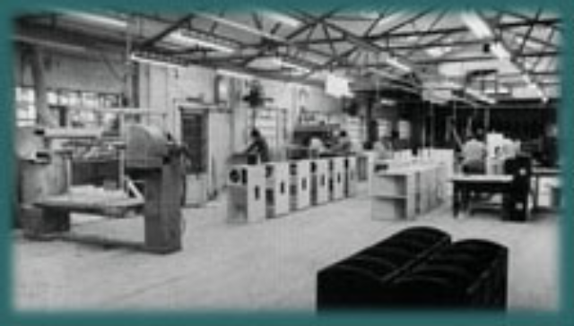

some visible there in an old photo from the turbosound factory
Posted By: Tocooltom
Date Posted: 16 December 2011 at 4:05pm
That pic is old skool! where did you find that?
Posted By: cravings
Date Posted: 16 December 2011 at 4:47pm
it was on the turbosound site in the past. i can't work out what the ones in the foreground are.. they look like shells for martin phils or something... i wonder did SSE build for them too? tony or someone might know.

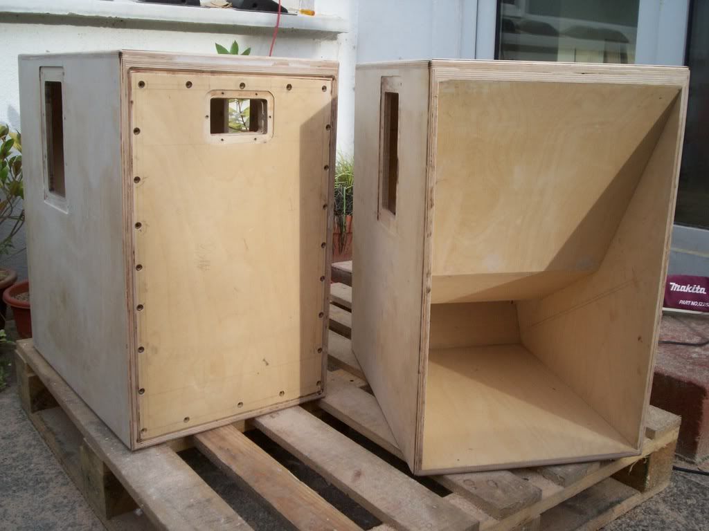

I've just gone n built myself 2 EM15's which have very similar dimensions/layout. Loaded with kappa 15lfs and loving the way they sound :) Wil put photo's of the build on new project forum!
Posted By: cravings
Date Posted: 20 January 2012 at 2:18pm
sure do look very similar! nice

how those the speaker install in these like the usb or the hd with the magnet inside the chamber??
Date Posted: 01 March 2012 at 1:28pm
if you look at the original plan on page 1, the driver is mounted with the magnet inside the chamber like a HD.
How much difference would it make turning the driver around to the USB style?
Posted By: smoore
Date Posted: 01 March 2012 at 2:56pm
I dont think the driver will sit in the throat. I held my driver up at the angles when i was building my single versions and the back of the cabinet gets in the way i think.. Cant entirely remember.. Anyway thought I would stick up a link to the ones i built if anyone fancies a ganders! http://www.facebook.com/media/set/?set=a.10150105889493951.284126.659953950&type=3#!/photo.php?fbid=10150493089183951&set=a.10150105889493951.284126.659953950&type=3&theater" rel="nofollow - http://www.facebook.com/media/set/?set=a.10150105889493951.284126.659953950&type=3#!/photo.php?fbid=10150493089183951&set=a.10150105889493951.284126.659953950&type=3&theater

@tocooltom You seen these?
http://photo.qip.ru/users/tda-audio/1155875/25513039/" rel="nofollow">
http://photo.qip.ru/users/tda-audio/1155875/25513038/" rel="nofollow">
No Bass No Fun
Date Posted: 10 April 2012 at 8:54am
Yeh ive seen that pic somewhere before, problem is that is a 218 cab (pretty much a USB)
Ideally i need a 215 because i want to keep the kicks a similar size to the punishers ive already got

Posted By: boots-hifi
Date Posted: 03 April 2013 at 10:28pm
Single version of the plans. 1 Cab loaded with PD 154 simed pink noise.
I will have 4 singles and two doubles loaded with PD 154's available soon.
Posted By: levyte357-
Date Posted: 03 April 2013 at 11:20pm
Simmed, or response plot mate ?
Posted By: bee
Date Posted: 03 April 2013 at 11:34pm
response plott mic not calibrated for spl, plott taken at 5m...... but calibrated in all other areas....
for a true measurment we should of done a signal sweep at 2m.....
Posted By: bee
Date Posted: 03 April 2013 at 11:37pm
no off the shelf driver in a bhp will get up that high..... even the claims that the turbo can go to 250 is a big stretch.... yes it plays that high but sounds very boom'y....... even with turbo drivers i would not play past 185hz

Turbosound "BPH238" = SSE Turbosound TB215
http://www.dghwells.clara.net/pictures/SSETS4.jpg" rel="nofollow - http://www.dghwells.clara.net/pictures/SSETS4.jpg
http://forum.speakerplans.com/assgaussmartinetc-old-brochures_topic24797_page10.html" rel="nofollow - http://forum.speakerplans.com/assgaussmartinetc-old-brochures_topic24797_page10.html

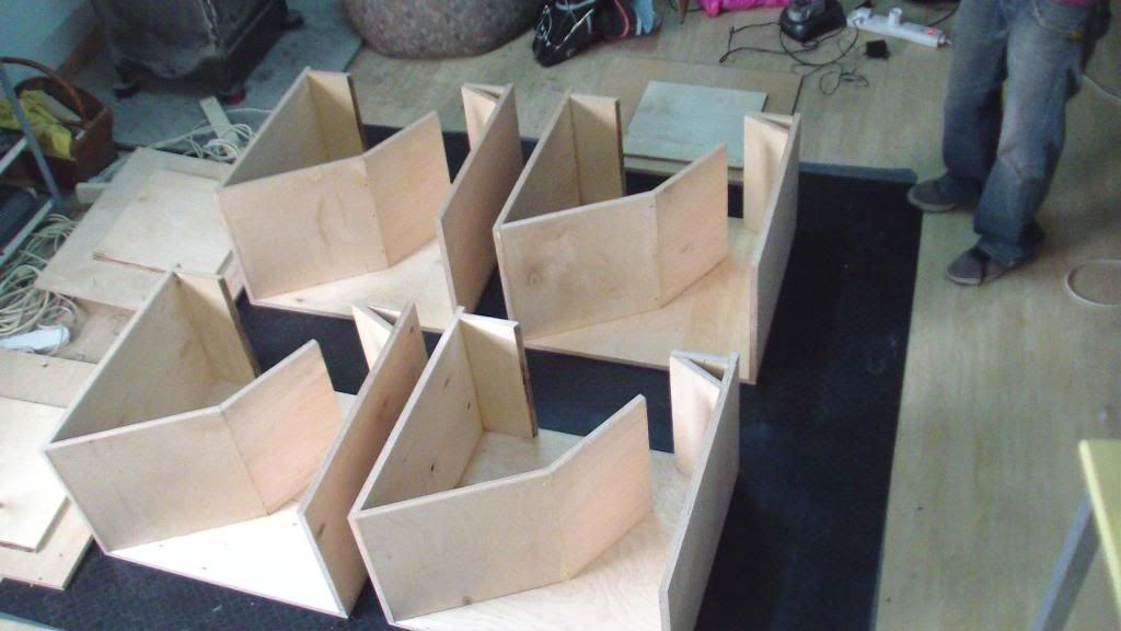

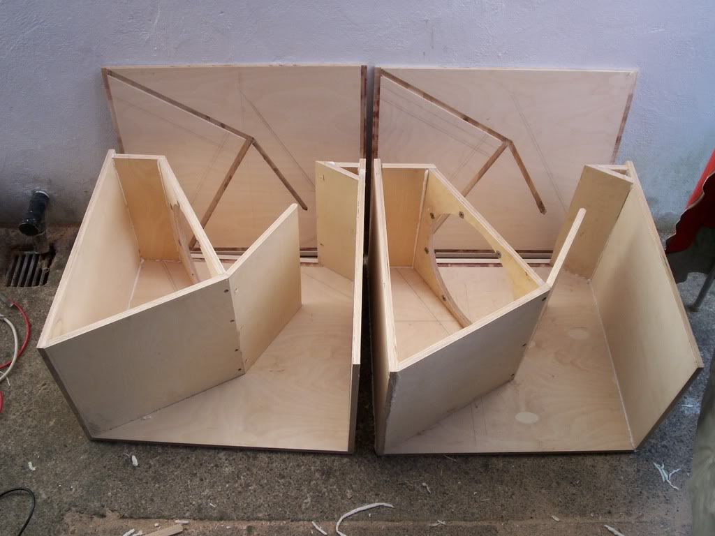

am in the process of building four of these kick bins and i was wandering if i will need to ad wading
in them?
Posted By: vragas
Date Posted: 09 October 2013 at 8:12pm
http://s276.photobucket.com/user/versionman/media/SAM_0037.jpg.html" rel="nofollow">

@chiourme
SSE copied the designs and sold them as their own until turbosound got onto them
Posted By: cravings
Date Posted: 18 October 2013 at 10:04am
i thought SSE were building them legitimately for turbosound. both names were on the back of them.
Date Posted: 20 October 2013 at 12:01am
yes they were building them for turbo, but they also decided to sell them off to buyers in the uk and europe under the noses of turbo. One day turbo found out and cut all ties with SSE. As you can imagine their relationship has never been the same since.
Posted By: cravings
Date Posted: 20 October 2013 at 4:10am
wonder what driver the SSE ones were loaded with then.

Date Posted: 20 May 2014 at 1:30pm
http://s276.photobucket.com/user/versionman/media/sound.jpg.html" rel="nofollow">
