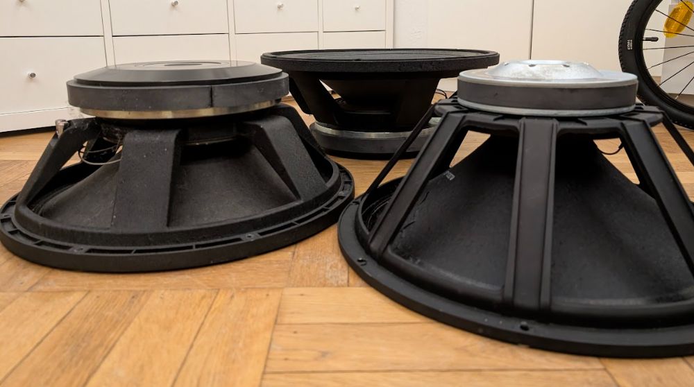

Thanks! There were Celestion OEM drivers in the TMS Low that I have (blown), but it's an 18" driver with 4,5mm xmax, 3" voice coil, high Qes & Qts,... So I assume the VOID will be a better alternative to fix them. Here are some pictures of the drivers side by side
I did compare the measurements (like diameter and height) but not the diameter of the magnet unfortunately Smile

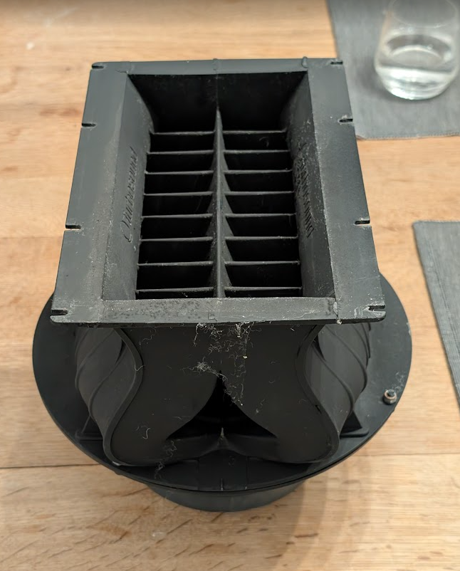

I like them, they go loud and clear. Only downside is they only play from 180Hz. Here are some pics of the horns
I managed to get the VOID V18 in theTMS Lows and it sounded good. I didn't use the Admark, but a Powersoft M50. I'll try to test with the Admark asap and do some measurements!
