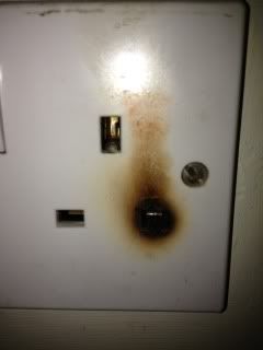

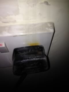

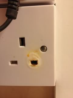

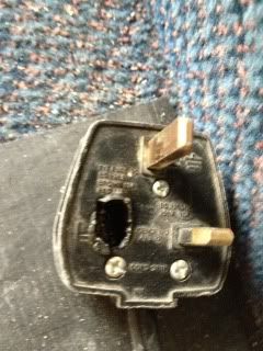

Heres some electrical dodgyness at a place I'm doing some work at the moment.
All of the live sockets are like this.
I found this to be the source of a strange burning smell! the plug in this picture was smoking a bit, and was so hot I couldnt touch it! The top part of the fuse was more or less melted through the front of the plug! th 1.5mm flex was kinda toasty and very soft!
That socket after the plug was removed...
And the plug afterwards!
Connected to the end of that extention reel was a 3kw heater, a 2.2kw heater a 500w floodlight a table saw and a hoover!
I worked out that they were pulling a sustained load of 24 amps through that poor 13a plug!
It had been managing this for some hours aparently, and quite a few times before hence the 3 burnt out sockets around! they just kept sticking new fuses in and carrying on till they popped, until the plug could take it no more and completely burned out the live pin.
I'm quite surprised that socket didnt catch fire! I was fully expecting to walk past and see flames. Madness!
