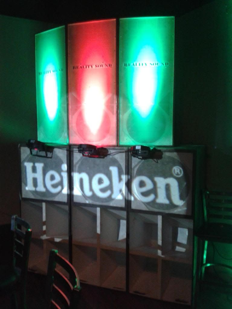

Posted By: RealitySound
Date Posted: 18 January 2014 at 12:27am
I managed to get 8 18Sound 21LW1400's for $3500 (USD). I would be happy to link anyone on the East Coast/ Caribbean to the dealer I use if someone wants some.
Wouldn't want to lift these up stairs. Dead I am fortunate enough that my scoops will never have go up any stairs as all the venues I use them at are outdoors or indoors at ground level.
I would put 4 of these up against 4 double 18 reflex  ANYDAY. I am quite confident as I used to own a boat load of double 18 reflex, and they don't come close.
http://s150.photobucket.com/user/ob1bda/media/21LW1400%20scoop/IMG_0552_zps94ce0d67.jpg.html" rel="nofollow">
