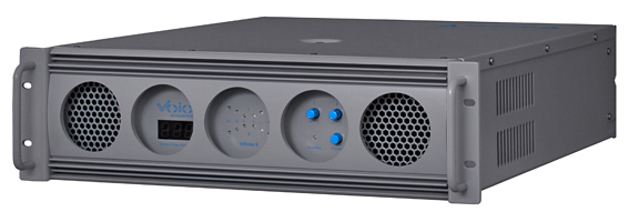

Have a bit more work to do on the look, but here's how the Infinite 8 v2 is coming along.

It looks nice, but looks a little lacking in the illuminations department,  it might be tricky to see whats going on in the dark.
Whats the LED display for? Temp?

No handles ?
Posted By: Fushion Julz
Date Posted: 14 February 2007 at 8:23am
Sorry, Rog, have to concur with Cowfoot...Handles are a must-have for an amp of this size and weight...
what is the LED read-out for?
because the gain controls are so small and recessed, some sort of illumination for them would help immensely

The LED read out displays the current draw. Its an rms average reading and displays how many amps are being comsumed.
The amp weighs 38Kg and I don't agree it needs handles. I can lift one into a rack on my own and I only weigh a bit more than one of those amps. If I can do it anyone can. There's no handles on Crest CA 18, none on a 9001 and the ones on a VZ 5000 just rip ya hands off and get in the way.
I have no idea how much these will cost, I just design them.
If you want an idea of the current draw you can expect read this thread.
http://www.speakerplans.com/forum/forum_posts.asp?TID=8428 - http://www.speakerplans.com/forum/forum_posts.asp?TID=8428
If you want to know whats inside the amp and general construction this is what I said in another thread.
"For those interested the new Infinite 8’s output power is now slightly higher than it was. This is due to a triple output stage and supply. The highest stage is running around 170 volts. The capacitor reservoir has also been enlarged. There are now 400,000 uf of capacitors, yes you read that right, that’s nearly half a million uf of caps in the v2 Infinite 8. The v2 also uses 6 bridge rectifiers and the highest power output transistors available. Another 1.5Kva has also been added with a larger transformer."
I would also add to this that this amp is not to be messed about with. In bridge mode I've measured 180 volts coming out into certain impedances. No bell wire with this baby I'm afraid

i agree with the other guys Rog,on an amp of this size/weight/cost i think handles are essential,im sure they could easily be incorperated into the 2 rack end brackets?
Several times i have tried to balence an amp on one knee whilst trying to slide it into a rack by myself,it would be impossible without 2 front handles me thinks.

Ok I will look into it fitting handles. But I also have to say that although one person can install an amp this heavy into a rack, I think two people are mandatory.
Here's what the rear looks like.
It looks like there are only 2 fans, but there are another 2 inside. There's enough air flow on this amp to take off, ha ha.

Ok, so I suppose the next thing you are going to say is that the rear panel is too busy and what do all the buttons do.
All v2 Infinites now have a built in crossover network. Each channel has an adjustable independent crossover so one channel can be used for say bass and the other for midtop. It goes further than that as the crossovers have outputs that can be used to drive other amps or even your whole system.
The other buttons are for independent 25Hz Hi pass filter’s, independent limiter switches, a parallel both channels button, bridge mode button and ground lift button. The crossovers can be adjusted for different frequencies and each channel can use either a Hi pass or Lo pass filter or can have the filters bypassed.
A 4 core cable can be used from output 1 to enable midtops to be connected. Channel 1 is output on pins +1, -1 and channel 2 is output from +2, -2.
Talk to void to see if there are any dealers in France or maybe talk to a dealer in another country that can ship.
The cable is rated above the maximum current draw, there is also a fuse for protection. The amp will come fitted with a 16 amp CEE Form as working current draws are not likely to be too high.
