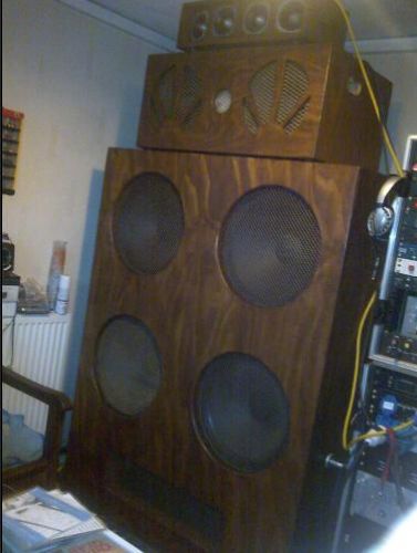

Starting to build, looks wonky cus not yet glue probley as this point..Big smile
glued top bottom ect Routered out baffles and port and round over baffles...nice sunny day Big smile
Shot of the close up port, little lip for the grill to seat on...
Sanded down filled holes and rounded over...
Box stained...started to add bracing, and battoning
Box side view stained...
Rear stained and access panel routered out...also a little routered lip around the edge of the rear panel, didnt want it to fit flush, thought it looked more vintage sytle...
Rear of acess panel with the gold cup washer , thought it looked nice touch imho...
Close up shot of top-box with some hf250s for tops, just got to build some mids now to the rectro style of the boxs...gonna be loaded with fane 18b's, so should make some nice noise/tones, as ive said before ive built it for a bit of fun, and on very very limited budget, as its cost me next to nothing to build it with some resorcing 2x2 bracing and battoning ect
from neighbours and friends...and a bit of work to build it...
so all got to do now it router some baffle rings to attach the grills, so the drivers are sealed to the baffles....and get some expanded mesh for the grills and port...
and give it a once over with clear satin varnish...you may not think but it is solid with bracing/battoning from the top/bottom/sides/front so should be good man......also the stain hardens up the exterior, also with a splash of varnish to do still....wadd the rear panel...Job Done!
to all have fun building....may not be the taste for some people man but i love the old style sound boxs...
Musical Roots Reggae Vibration is Life! for music is sound...sound is vibration...vibration is energy... and energy begets life. Therein lies my passion!...MUSIC IS LIFE...

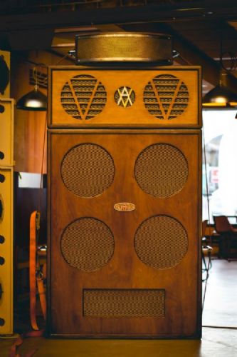

As you are doing external grills, you will have a choice, not sure what I would do though with that style box. You could either do a normal ring with the metal grill or cut  a pattern in the middle to look like S&P's. This was my take on the metal grill cover.
https://imageshack.com/i/mrdscf0884kj" rel="nofollow">                   https://imageshack.com/i/5bdscf0881qj" rel="nofollow">
https://imageshack.com/i/5bdscf0881qj" rel="nofollow - -

Tony, grills on the quad and mids that im gonna build are Internal, want to flat expaned mesh , gonna route a pattern on the mids tho and some mesh behind still
but have to admit tho they look very tasty round grills, you make them yuself?
thanks...
Posted By: TONY.A.S.S.
Date Posted: 25 June 2014 at 10:09am
Yes, Grill surrounds are made  from ply. That's the reason I showed the photo again.
http://www.facebook.com/tony.rossell.3" rel="nofollow - http://www.facebook.com/tony.rossell.3
Posted By: Dub Specialist Sound
Date Posted: 25 June 2014 at 10:15am
Wow Tony buitifull surrounds...
thinking now Lionpulse Soundsystem have done them speaker grill rings on there Scoops and mids
really like them ....great wood-work!

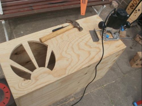

Just a few of pics on the mids ive built yesterday , to go with the quad...
making some saw-dustSmile
both routered out...
design sharpened up filed and sanded...just a bit of bracing and stained to do...

Excellent work, I've always liked Sun Ray shapes, I think they are timeless. I assume you have enough space behind for cone excursion.
Date Posted: 27 June 2014 at 10:16am
Big thanks tony,
yes sun-rays is a nice design from/simlair to the victor loudspeaker,
oh shit excursion slipped my mind for a mo , not sure on x/o yet maybe around 130-150 so not much excursion at that frequency range?
just thinking now how am i gonna do that now, maybe a ring baffle from the inside?
any idea tony?
big thanks..

I think you have already got the answer, but to make sure, you could do another loose baffle inside. Including the speaker gasket, depending on whether it's hard or squashy, I would say a 12mm sub baffle will get you out of trouble. It's true, above 100hz you are hardly likely to get any excursion, but it will depend on what sort of safeguards you have in place, i.e. crossover points, whether a bass cable can accidentally be plugged in etc. Not a major problem at this stage.
Date Posted: 30 July 2014 at 12:21pm
Just a little update, to who is interestedBig smile
loaded now and grilled up , the double baffle not yet glue propley lol as need to source some proppa expanded grill/mesh , this sheet was just a cheap n cheerfull just for now, untill i router second baffle for it to be recessed with the thicker grill...
could not wait to have a listen man lol yu kno have it goes....tbh quite surprised tbh how heavy thay can drop man...there is a nice tone to them too, will deffo do for sunday vinyl playying BBQ ect, need to do some proppa testing to see how it a sound!!!!
also thought did i do enuff bracing seems to ok at the mo, we will see when driven hard!!!Big smile will be played 4 way got some old vintage cast horns to sort out too and build a box for them, when played propley....heavy a @ too lol now i know!!!Big smile
at jamo come a pass tho man!!! respect...man...Thumbs Up
Date Posted: 28 December 2014 at 2:16pm
Yes app , very nice to my ears broBig smile, drops nice/heavy nice bass tones to it, yu need to really it manSmile
ive added a old vintage Cast Horn/comp to the stack now , so it runs 4way...nice, yu can just about see it top right .....on top of my deck..
Date Posted: 28 December 2014 at 2:23pm
Also a bit more went into the build ie doubled baffled , and more bracing and added a 2402 in the mid box...
also them 12" Fane mids are around 45years old now still going strong old 4 arm cast chassis...nice tone to them man..

Date Posted: 05 February 2015 at 9:09pm
Just building another double 12" 'Vintage Mid-Range Box' the Vintage Sunray, water and clouds design from the 1930s/40s, all done by hand rough jig-saw no router,
the template was cardboard drawn by my son, all filed down with 2 files round and a flat and some sandpaper, took me bloody hoursBig smile but worth it
got to be sanded down and Wood-Stained and build the rest of the box, thought get the hard/tricky bit out the way first, as yu can flip and turn the front panel with ease
BUT im wondering does any one have any opinions on the percentage opening of this design as there isnt a lot of it really, dont worry about the knots iether tha look lovely when sanded down and stained gives it a great wood effect...imho
is it gonna affect the sound? ie block a lot out?
thanks...

Posted By: KidCreole
Date Posted: 05 February 2015 at 9:19pm
Keep the design as is, but perforate it with drill holes. That way from a distance you will still see the picture
more than 50% you will need

Posted By: bitSmasher
Date Posted: 05 February 2015 at 10:22pm
Would create some sort of bandpass effect, no? Regardless, looks fantstic!
Date Posted: 06 February 2015 at 7:19pm
@Valve Heavywieght toroidal transformers i'm afraid would love to have the money for a valve section man, but also dont know alot about them tbh...oneday maybe 'love too'
@Kid nice idea dude but didnt really want to do that tbh, would mess up the that lovely design man, 2nd thought's now dont think im be using it now..shame really..
thanks all

Posted By: app
Date Posted: 06 February 2015 at 7:25pm
thanks all
Use it man!
Try to somehow calculate when theres about 50/50!
Go for it! Its a beauty!

Lovely! Did you manage to calculate the empty space in the "grills"?
You have a lovely vintage sound! Clap
"what!?"
Date Posted: 07 May 2015 at 10:42am
TBH App , no thats what im worried about , the percentage of open space for the mid-range
im sure some one did mention how to do it , not sure now tho
if not will have to load it and give it a good listen.....
cheers everyone!
