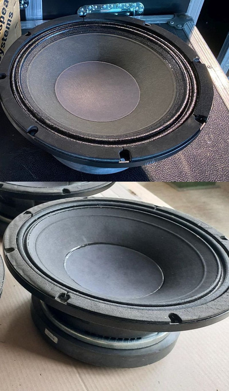

Hi Did you ever find out why your 12" driver was marked 16 ohms?
  I have blown a 12" in a W8C and am looking at options for repairing/replacing it.
I don't see a L12P520 on the RCF website but there are some re-cones available on bluearan and on ebay.
  Does anyone have any spares?

I have blown 6x of the 6.5" drivers from my W8CT (after a DSP fault).
  Did anyone find any recone kits available? This is going to get quite pricey if i buy all new drivers (+shipping)!
Also on a side note i ended up replacing the 12" drivers in my W8C's with the RCF L12L750 (8Ω). Seem to work ok.
  But i would probably want to know the exact driver if replacing any in my W8CM because i have 8 drivers in total and they work together in parallel.

Hi. I am on the verge of buying 7x PHL 1050 as a DSP fault blew 6x mids in my W8CT's and later a W8C also blew a mid trying to keep up with the bass because my CT's were not available or perhaps it was a DJ error, i was not able to be in the room all the time as we had two rooms at the time.
  I came close to getting someone to wind me new voice coils but it never worked out and PHL (THPL) do not want to get involved in spares or repairs.
  Really i want to upgrade to something with a higher power handling but apart form the PHL 1510 which s both v expensive and also does not have an inverted dust cap to help fit close to the phase bung the only other 6.5" drivers i can find with higher power handling are mid bass drivers. But do you think this could work, something like the B&C 6mbx44? After all i will be only using it between 794Hz and 3k24
  The PHL 1050 has the back of the chassis holes closed off with plastic shutters which are simply glued in place. If i replace with 1050's i only need 7 but if i replace all 6.5" drivers i will need 14x drivers so i don't really want to go crazy on price.
  I was just wondering if the W8C have a different impedance to the W8CT as the CT's have 3x 6.5" per cab and the W8 only 1x 6.5" per cab having 3x 16 ohm in parallel makes the mid channel around 5ohms per cab but should a W8 really have a 16ohm driver if you are say only using a few cabs rather than a load in parallel?
  I am wondering what the OP had in his cabs and why they were 8ohm?
Any ideas or insights would be appreciated.

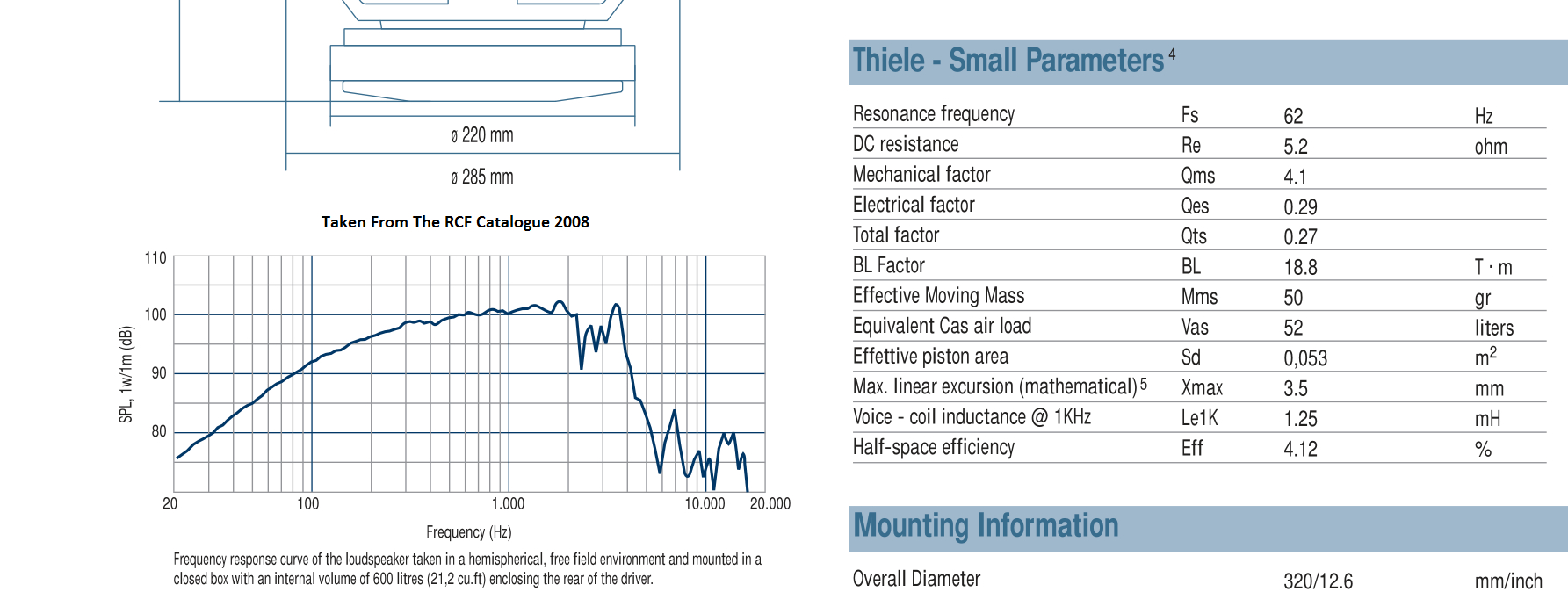

Posted By: Luca FMA soundsystem
Date Posted: 06 November 2025 at 4:50pm
Hello I have come into possession of 8 pieces of w8c and I'm thinking about changing the 12" you can send me the frequency response with RCF L12L750?
Posted By: Elliot Thompson
Date Posted: 06 November 2025 at 8:21pm
I was going to refer you to the RCF website until, I noticed, they do not offer frequency graphs anymore. Confused
Nevertheless, here is the frequency response graph from the 2008 Catalogue...
Best Regards,
Elliot Thompson

Did some searching on the net for some real photos.
Have combined a photo with the Martin Audio DLS252 at the top, and the RCF L12750 at the bottom, for comparison.
https://postimg.cc/34jHm9MH" rel="nofollow">
