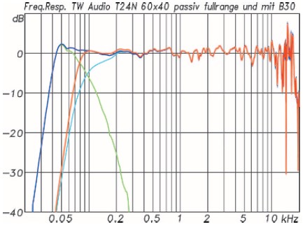

Steve: you mean 3" drivers for the midrange? Then it would have to be a 5way system at least. You can't just go from 12" LF drivers to 3" mids.
As far as the sub-bass bass is concerned, we're pretty happy with our NLW9600s. I know plenty of expensive Hifi speakers that don't offer bass that's any more precise.
jody: which 2" is that? Here's a measurement of a TW audio T24N with a 1,4" HF driver:
