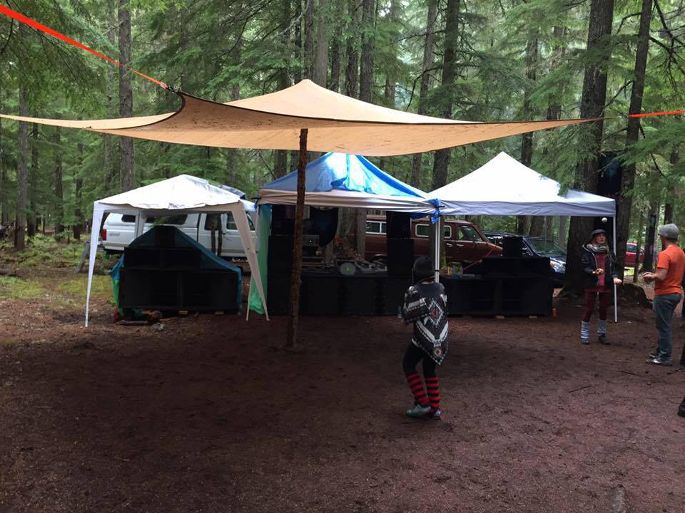

Posted By: bob4
Date Posted: 06 September 2016 at 6:41am
Originally posted by b grade b grade wrote:
HF stacked vertical + physical time alignment Thumbs Up
Posted By: Sapro2
Date Posted: 06 September 2016 at 10:36am
You always have lovely locations for your venues B grade. Do the mid horns reach high enough to meet your tweeters?

Posted By: all bass
Date Posted: 06 September 2016 at 11:36am
Looking great!
No job for the reflex subs this time?
Oregon is the most beautiful place on earth. (when it's not raining Wink)
Posted By: b grade
Date Posted: 06 September 2016 at 2:10pm
The tweeter boxes are actually a slightly larger range than you would think. My lo-fi(nance) solution was to make a 2way passive crossover box. The dual horns are the same but the drivers are different. The lower horn has a more vocal mid comp on it and that can technically go lower than the horn, but not as efficient as the hf comp. Still it bridges the gap pretty well without costing ridiculous money. Obviously I would prefer to have less crossovers. I can run the tweeter boxes as low as 800 hz before it starts sounding horrid, but I usually run them at about 1.2khz. The passive crossover between the comp drivers is at 4.5khz I think.
Thanks for the kind words about the spot. This one was extra special, and found at the very last minute too. I almost did this party in my basement. LOL. My first time running two different rigs at the same party. My B system was fun too, but I forgot to take any pictures. That one was for a super low extension chill room. The one in the picture was for loudness, with a retro 90s goa theme. Free and illegal for authenticity.
Posted By: b grade
Date Posted: 06 September 2016 at 2:22pm
Originally posted by all bass all bass wrote:
Looking great!
Hi all bass! Hope you are well.
Second stage had the BP6s. I could only fit two in the van, but they were singing all night. On each side, above those I had a single 15, and then a coaxial mid top. It was for a small covered chill area, about 30 meters inside the tree-line. No soundbleed at all, and the stages were probably less than 100 meters apart. I love trees.

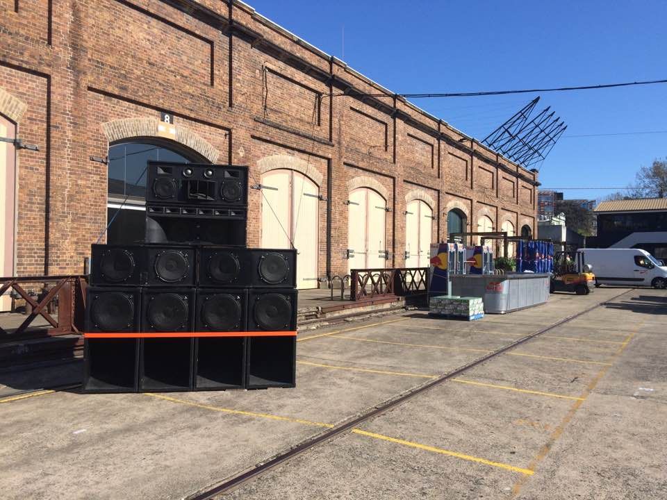

Red Bull sponsored "The Great Antipodean Reggae Soundsystem Carnival" in Sydney Australia yesterday on Sunday. 4 sounds system out doors from midday to 7, noise police got upset around 5:30 but a great day for all involved.
