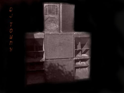

Would the RCF L12P300 driver work well in the Punisher. I have a few of these as spares and want to put them in Punishers. Would they fit and what would there output be like. Any helps good help. Don't need other options, just need to know if they'd work alright. Thanks a lot. Ant

Just to say, the RCF's work in Punishers extremely well. Pumping out loads of clean bass :D
