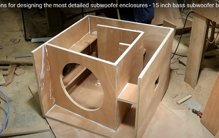

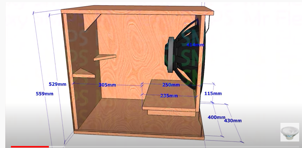

Hi
I will go ahead with those RCF LF15X401 drivers. As they dont cost too much and I think they will cover my excpectations.
http://www.loudspeakerdatabase.com/RCF/LF15X401
I have two a littlebit different box design in mind. They just look enough good to me.
Which one should I prefer? What is main difference?
And what simulation program do you suggest me to use to model these boxes. Because I dont have any idea how to get those internal dimensions of box (also port sizes etc, all those angles). I am familiar with Bassbox pro program (I used it for home speakers). But thats my first PA project, so many questions and not knowing details for me.
Thank you for help.
You need to stop watching those videos from Indonesia. They have no idea what they are doing overthere. Get some plans that are actually tested and proven.

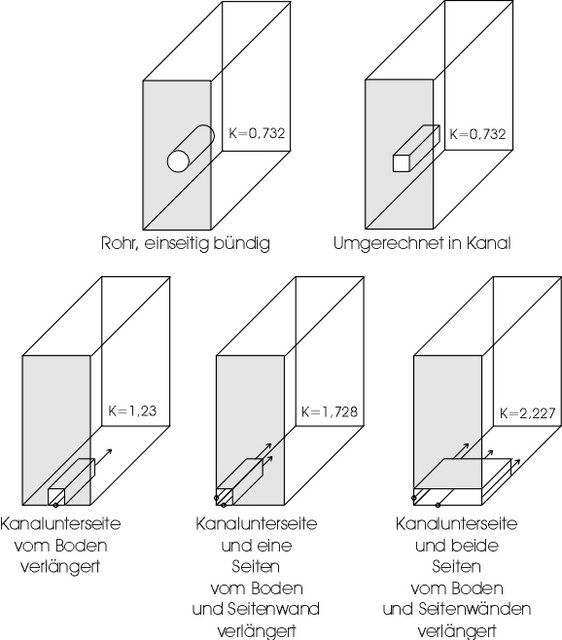

If building a rectangular "shelf" vent as shown in the images you shared earlier, be aware that it will tune the box lower than the simple predictions from software like WinISD, which is what I use.
That is because this software, and many others, assume the back end of the port is well away from the walls of the cabinet.
When built in as a shelf, the opposite is true, with 3 out of the 4 walls of the port being a lot longer than the shelf itself, so some of the air immediately around the back end of the port behaves as if it's part of the port rather than part of the cabinet volume. One way of approximating this change is to manually calculate the required vent length, with a different end correction value, rather than using the length predicted by the modelling software. (If Unibox allows you to change the end correction value, try increasing it to 2.227 instead of the default. This will get you back to a manageable port length.)

I simulated again that driver in Unibox, there is also port end correction option, which is set to 2.224.
I wasnt aware that impact at all, but to think about, there is definately physical impact what shape and location port have. Again something new for me.
Here are some german layout also from ports end correction:

Yeah, that's the same info about end correction I was working from, so we're on the same page there.
I would do rectangular ports, if you want to build it 450mm wide overall using 18mm plywood you'd have 198mm wide for each port, 88mm high and 431mm long to get the modelled airspeed.
If you went with 15mm plywood, which is probably OK if you're mostly using it in your garage & it's well braced, then you'd have 202.5mm wide x 86mm high by 431mm long, for the same vent airspeed.

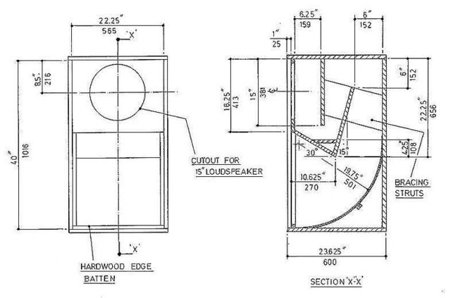

Btw-does wider speaker enclosures produce more SPL, due baffle step? I mean if front baffle is wider, baffle step point is lower and more energy is directed to the listeners? Energy cant go so easily around the edge of baffle. This one I am going to build is quite narrow compared driver.
Just for curiousity:
In german forum I found totally different design also for that driver. It looks then horn type, I guess.
Do you have any idea, what could be advantages of such a design?
https://posts.org/ -

Post Options Post Options   Thanks (0) Thanks(0)   Quote DMorison Quote  Post ReplyReply Direct Link To This Post Posted: 07 March 2022 at 9:01am
Hi Ringo,
For a sub, we're mostly operating below the frequency at which the bafflestep has effect, so it won't really change much. It is far more relevant for full range type speakers.
Even then, the low frequency part of the speaker's response is still likely the same for different baffle widths, so we'd end up pulling the mids back to match that anyway.
The other design you posted is what's known as a scoop, or sometimes back loaded horn. It will be more efficient, at least over part of it's bandwidth, but may also have a more coloured sound. They also tend to have a distinct notch in their frequency response that limits how high they can usefully play as the sound from the horn part is out of phase with the direct sound from the driver.

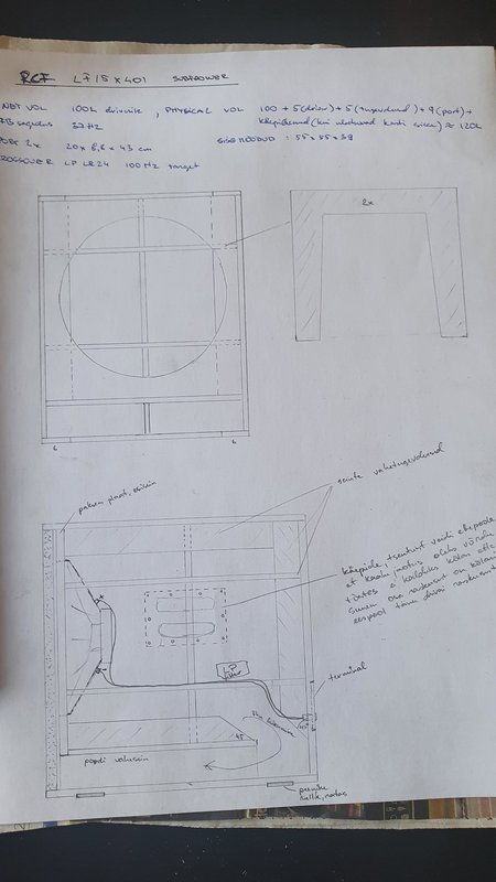

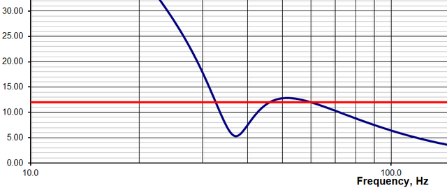

Post Options Post Options   Thanks (0) Thanks(0)   Quote ringo34 Quote  Post ReplyReply Direct Link To This Post Posted: 14 March 2022 at 12:09pm
I already made some plans for enclosures. Your plan and dimensions were nice help. I try to make front baffle maybe even from 24mm plywood, other walls probably from 21/18mm.
But I came up with one question, when I checked driver Xmax in enclosure. It is exceeding slightly 11.5 around 50Hz.
Could this be a problem for me? Should I lower Vb to get it under 11.5 mm?
DMorison View Drop Down
Joined: 14 March 2007
Location: Aberdeen
Points: 1740
Post Options Post Options   Thanks (0) Thanks(0)   Quote DMorison Quote  Post ReplyReply Direct Link To This Post Posted: 14 March 2022 at 2:45pm
That sim does not look like it includes the effect of the Crossover & EQ filters I modelled, which is probably enough to explain the difference of the basic box volume & tuning are the same. If you were going to use the same filters I included, you therefore wouldn't need to worry about it at all. If you were for example going to use a higher frequency crossover to your main speakers, that might allow a bit more excursion around 50Hz.
Simply not turning it up quite so loud would be all you need to manage that if it were a problem - the difference between 13mm in your model and 11.25 in mine is only 1.25dB, and I'm quite sure none of your audience will complain about a difference that small.
Also, Pretty sure that 21 & 24mm timber are overkill for a box this size, if well braced.
By all means do it if it makes you feel better, as long as you're OK with lifting the extra 8-10kg every time you move it Wink
You'd need to adjust all the dimensions to keep the net internal volume, vent cross sectional area and vent length the same as well; I can't see if you've done that already as postimage has shrunk your pic so much it's unreadable, sorry.

Post Options Post Options   Thanks (0) Thanks(0)   Quote ringo34 Quote  Post ReplyReply Direct Link To This Post Posted: 15 March 2022 at 9:23am
Ok, then i dont worry about Xmax. Probably they do not get very loud use at all, just bass extension for my main and mostly listen background music when I work outside of garage.
Yes, my simulation does not include crossover. Btw does your WinISD also provide that schematic for me?
LR24 it was if I remember correctly. I am good in wood working, but not so much deep technical stuff. So if you have also schematic for that specific LP filer, I would build that also.
It was just to show you that I am working already with plan. I will add higher resolution pic also. I havent jet added final internal measurements, maybe couple of cm here to there I will adjust. But overall I get ca 118-120 L total enclosure (100 for driver, ca 4-5 for driver physical, 5 for bracing and ca 9 for port). I will go then 21 for baffle and other walls 18, maybe bracing even 15 as they do not bend. They provide across strength.

Post Options Post Options   Thanks (0) Thanks(0)   Quote DMorison Quote  Post ReplyReply Direct Link To This Post Posted: 15 March 2022 at 7:44pm
That LR24 crossover filter is best applied to the signal before your amp rather than passively within the sub itself. That's because the component values required to make a passive filter at that frequency result in them being big, expensive and still they eat up a bit more of your amp power than is worth it.
Behringer DCX2496 is the king of entry level Digital Signal Processors for applying crossover filters, EQ etc, but there are certainly several others worth a look too depending on your needs.
Your plan looks good, BTW, good luck with the build!
