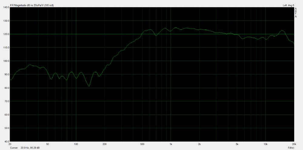

So yesterday was testing day, but despite the rain I had to go inside. Yet again these measurements took place in a (to) small room, so the results aren't reliable. Also a side note, I'm totally a rookie when it comes to measuring Wink
-Used amplifier whas Crown Itech-8000
-ND950 1.4 on the 18sound XR1464
With one PEQ applied around 10k:
I used the IR window function to get rid of the worst reflections.
Measured response without the PEQ looks almost the same as the specsheet
Hopefully the weather will be a bit better next week Cry

Thanks for sharing this. con you share gain and bandwith of the peq used at 10k?
smitske96 View Drop Down
Joined: 16 February 2016
Location: The Netherlands
Points: 1217
Post Options Post Options   Thanks (0) Thanks(0)   Quote smitske96 Quote  Post ReplyReply Direct Link To This Post Posted: 12 November 2018 at 4:44pm
+2dB Q=1

Thanks. looks like it covers quite a wide bandpass, it goes quite high AND low.
I wonder if the small room could have lifted response under 800 hz, but seems a little high for room gained bass…
