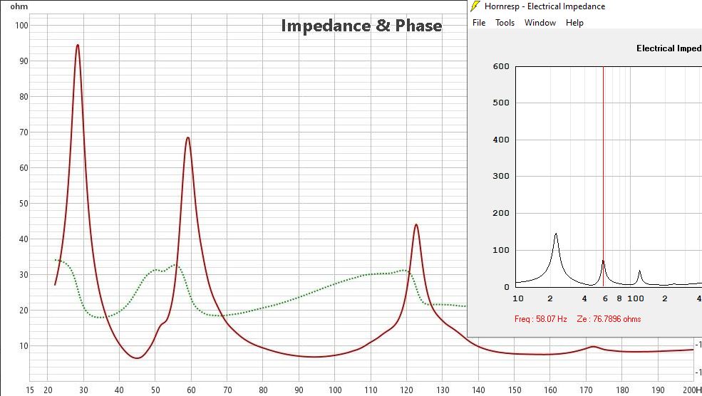

Once set up & calbrated an impedance measurement on REW is quick & easy - No hassle.
Measurement is a tapped horn compared to its Hornresp sim.

The OP (who is nowhere to be seen) stated 'self-built subs and we're looking to create some presets for our speakers' If you self build my advice would be to check the tuning.
I use Hornresp for more than ' cute response plots'. I'm fairly confident that is the case & that a fair number of people around the planet appreciate that!
The sim I showed is delivering over 3KW transients in the minimum impedances, So confirming the Hornresp parameters are real world correct helps with setttings that are not that easy to measure for DIY users but can be simulated. Optimising High pass filters on the subs for instance.
