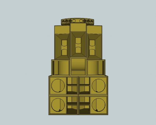

4 ms-18 mkii loaded with void v18 1000s powered by 1 FFA -10000 (3000w a channel at 4ohms - 2 ms-18s in parallel a channel)
3 hd 15 loaded with pd154 powered by FFA - 8000
3 of some midtops i've modded loaded with eminence delta 12 powered by a SAE PQM 13
a set of 8 bullet tweeters powered by an amp that will give out 500w rms

@kr1sounds - My bins are loaded with PD1851s and they sound really good. A nice deep round bass. My bins are larger than those in the sketchup coming in at 1230w, 763d and 555h.

with the amp giving out 3000w at 4ohms for my bass section, the speakers give out 1500w.. each.

if your speakers give out 1500 w they are the loudest ever build ;) you surely mean they get 1500 each

oh yes thats what i meant LOLLOL

im not too keen on the mid box i "modified" though

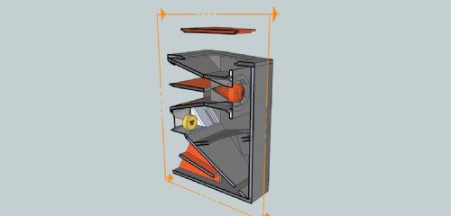

Tried to reduce colouration by porting into the horn, hence the slit. all Sim'd up alright.

very cool dave!
