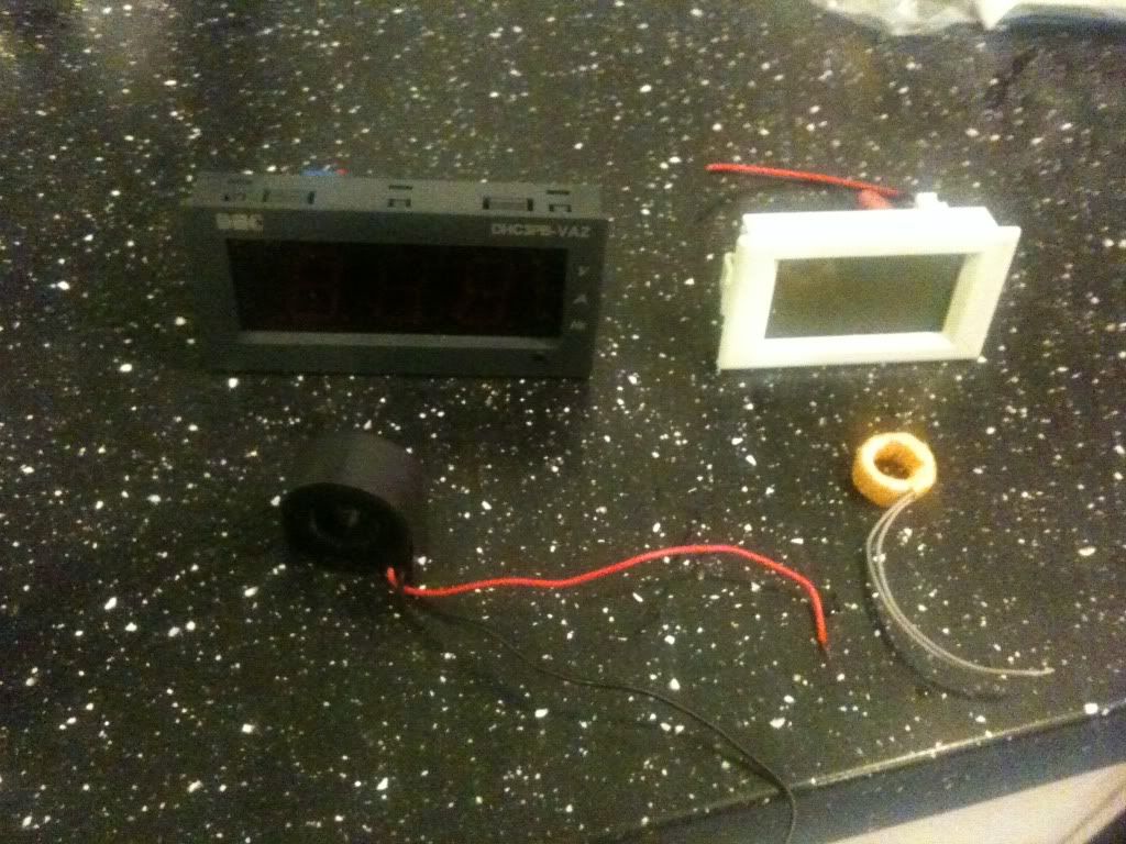

Ok, status update...
2 meters Black one to known a "cheap chinese meter (CCM)" and white one to be known as "very cheap chinese meter (FCCM)"
FCCM paid for on 10th, arrived 26th...
CCM paid for 31st, arrived 2 days later...
Ebay link used ;-
FCCM
CCM
I have to say, both were packed to withstand a Nuclear hit, and even a UK courier, so 10/10 there, remember CCM does Amps/Volts/hertz FCCM only does Volts and amps...
here's what you get :-
![]() So next step is to drink tea and go to bed...

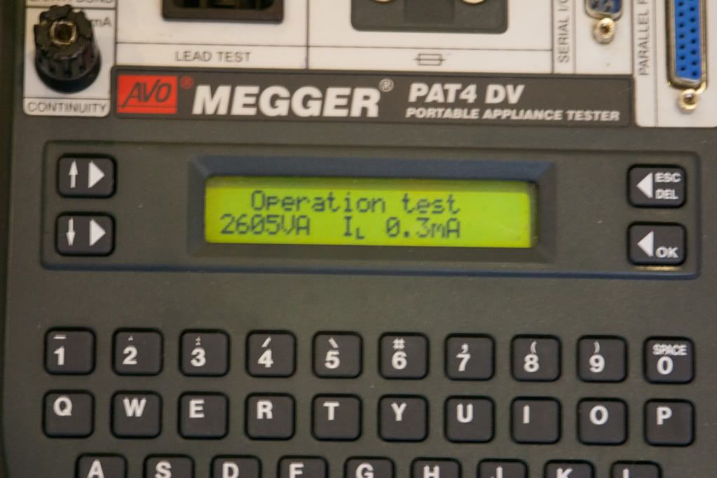

I've done this, all good, I also "patched in" a FCCM for testing, now to keep it simple a single load, my kettle...
Easy way to get loadin? use a PAT device :-
![]() so :- 2605 @240V = 10.85 amps
Results from the meters :-
![]() Not spot on, but OK...

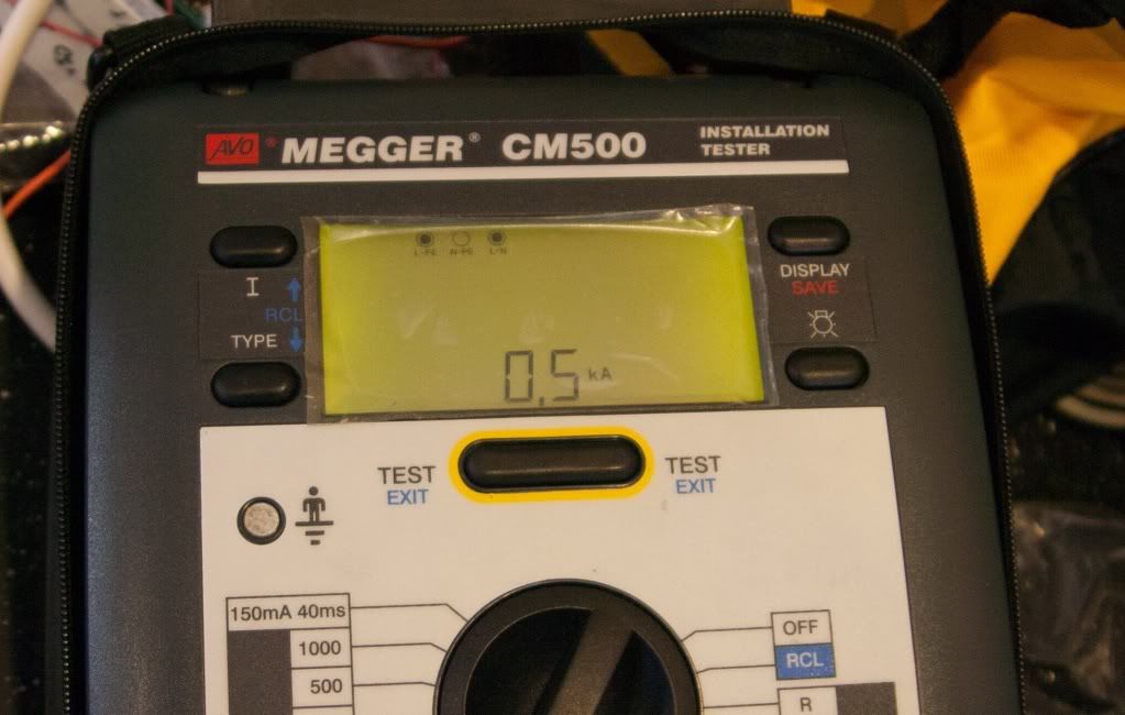

Ok lets do Line voltage :-
![]() The Cm500 read 243 so no argument there!!!!

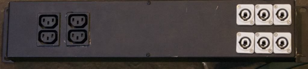

so this :-
![]() Gives this ;-
![]() which is 3 x 20A circuits on 6 x Powercon
2 x IEC out on 6A and 2 x IEC out on 10A.
