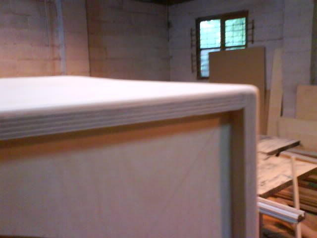

hektik View Drop Down
Joined: 12 October 2006
Location: NORFOLK
Points: 217
Post Options Post Options   Thanks (0) Thanks(0)   Quote hektik Quote  Post ReplyReply Direct Link To This Post Posted: 03 September 2008 at 6:26pm
Originally posted by Static Age Static Age wrote:
I like to do as much routing as i can while the cab is still a flat pack. That way i cant possibly hit a screw.
if ur good enuff you can do it with a soft pad on a grinder .and you wont hit screws..practice with a piece of scrap first...its really quik and quite easy wen uv had a bit of practice took me about 5 mins per cab  ill put sum piks up of mine tmoro ....look in new projects ...then 18" mini scoops theres sum piks up now but thats before id rounded the corners..
Location: NORFOLK
Points: 217
Post Options Post Options   Thanks (0) Thanks(0)   Quote hektik Quote  Post ReplyReply Direct Link To This Post Posted: 04 September 2008 at 5:57pm
there ya go
