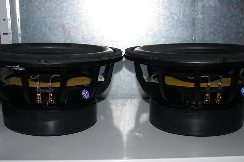

Thats my driver for the Punisher I also have the 15's for the Xtro and 1'' and horn for the xtro
if anyone's interested.

Thats looking good Mykey. Specs look terrific. Good to see the Vas is not to low. I take it the black line is the ture impedance and that the blue line is the delta mass compliance reference curve. If you're unsure, just say yes.
![]() Is the coil alu or copper and the diameter. How about winding depth and gap height. Under hung or over hung, or am I getting to personal now.
Shorting ring. Cock strap. There all things we dying to know.
You've shown us yours, but I'm not going to show you mine. Edited by Rog Mogale - 20 May 2007 at 3:32am |

Mykey,
can we have the TS data of those drivers? What will be the price here in Europe? Can they be used in Labsubs? Regards Edited by MarjanM - 20 May 2007 at 9:57am |

Your driver looks so close to the Lab12

Marjan,
The more common T/S parameters are listed to the right of the impedance plot. Like Fs 24.14Hz and Vas 106.24. I know they are not a comleate set and do agree that if Mykey could get a few more details it would help us all.
Maybe the new driver could be called the Hurley Worley.

Driver looks good Mykey, as Marjam said looks like v.similar basket as Lab 12 ...the coil is bigger tho?
