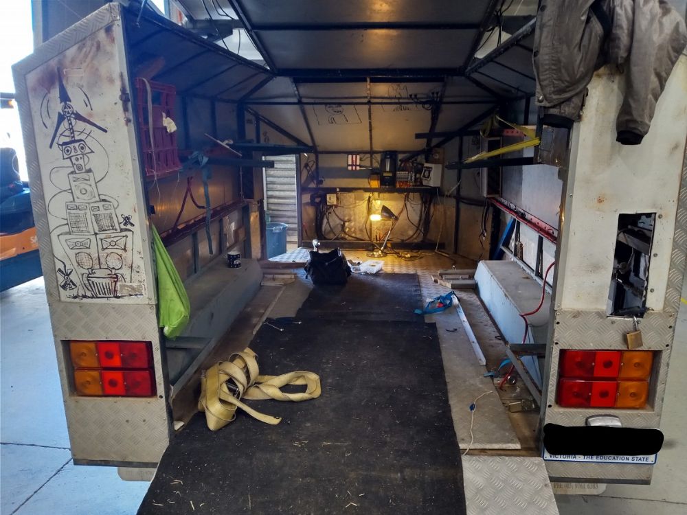

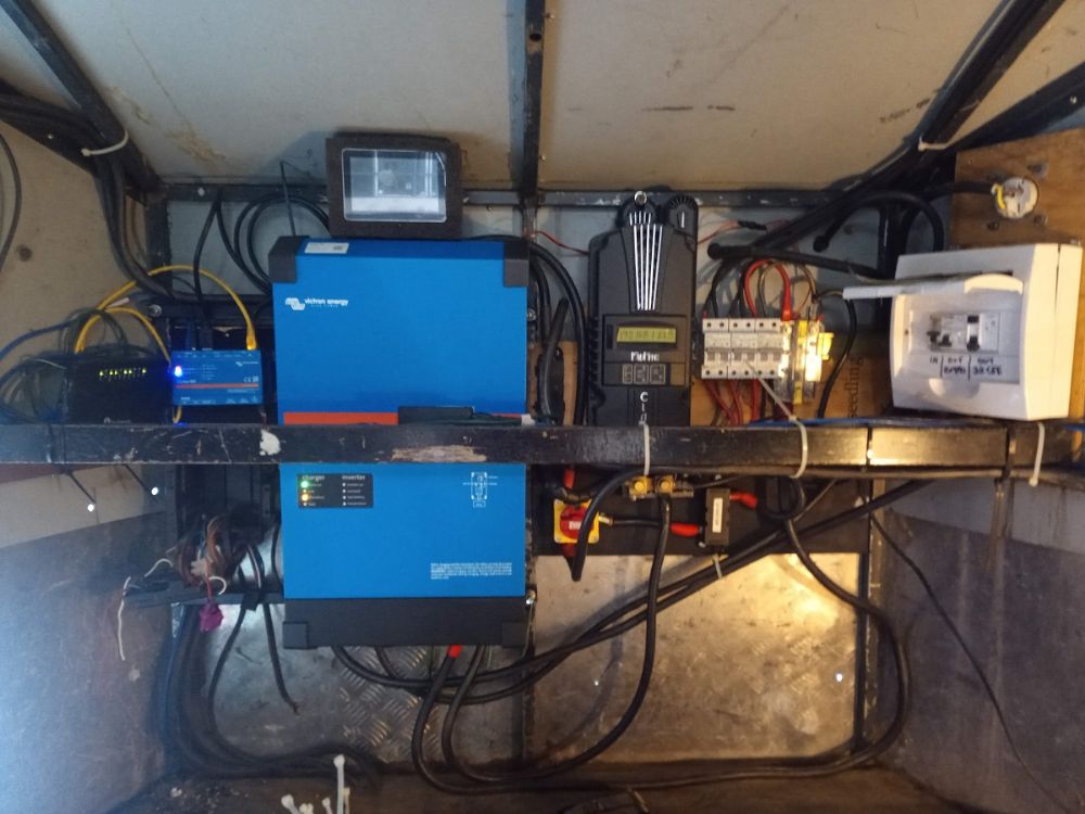

So after getting out of lockdown #6 this week we finally got access to our trailer and finished the install of our new battery/ inverter system...

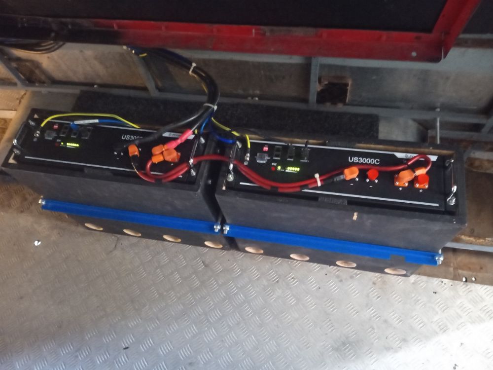

3 x Pylontech US3000c lipo4 batts
1 x Victron Multiplus II - 48v ..5K
With the Cerbo GX interface...
So first off was removing 1000kg of lead / acid batts !
Then installing the Victron gear in the nose of the trailer. Still a few bits of tidying up to do but it works ! And we have full web access, full control plus geo-fencing which is kinda nice. First problem was the trailer is a very good Faraday cage and no wifi gets in/out with the doors shut! An old household router that amazingly supports USB tethering and an old mobile phone on the outside got past that issue.
The mess on the bottom left is the trailer braking system which we still have to hook up... we have just lost over a ton in weight with the batt swap but we want an independant system contained in the trailer with it's own sensor and brake-away system. We need 12v though for that system and we are now at 48v ...so more bits are needed.
The pylontechs are vertically mounted in wooden sleeves with rubber suspension and foam inserts..holes at the bottom for cooling.
Now we just need some gigs ....sigh.

OK..so finally last weekend we got to do our first proper gig in a year ! It was a Dancehall party in the courtyard of a small club in Inner North Melbourne but we were allowed to set everything up outside with power from the solar trailer and able to run at a decent level all night, no complaints and the cops didn't show up...that was the first plus.
Second big plus was that it all worked. The new batts performed amazingly and when we shut the system off at 3am after starting at 5pm the day before the batts were still at 30% SOC. We had some solar input till about 7pm but never needed any backup power. No voltage sagging, no ripple alarms and being able to remotely monitor via the Victron phone app meant we could see exactly what was going on. We even ran the Keystone subs off the FFa 6k on the batt supply which we were always wary of doing before.
Third plus is actually a 4th one ! We are going ahead with buying a 4th Pylontech batt which should give us up to 12hours runtime with no input. We have already built the case and have the leads ready so it can just slot in.
We are all super stoked in our camp and pretty gob-smacked...
