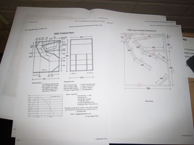

Post Options Post Options   Thanks (0) Thanks(0)   Quote Sinfinity Quote  Post ReplyReply Direct Link To This Post Posted: 17 October 2008 at 9:30am

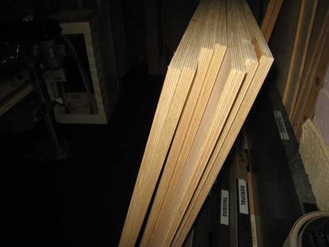

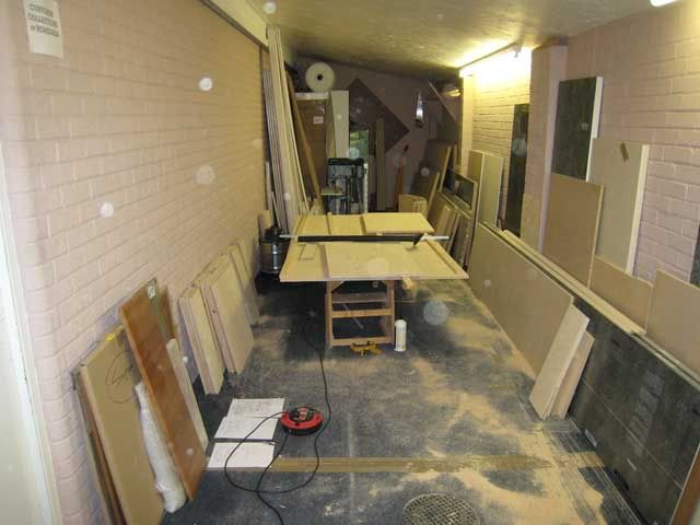

Some piccies. Took a few during start then kinda got stuck into build, will take some more shortly.
before starting a balanced diet of sawdust always read the menu
Matt at ukamp dot co dot uk

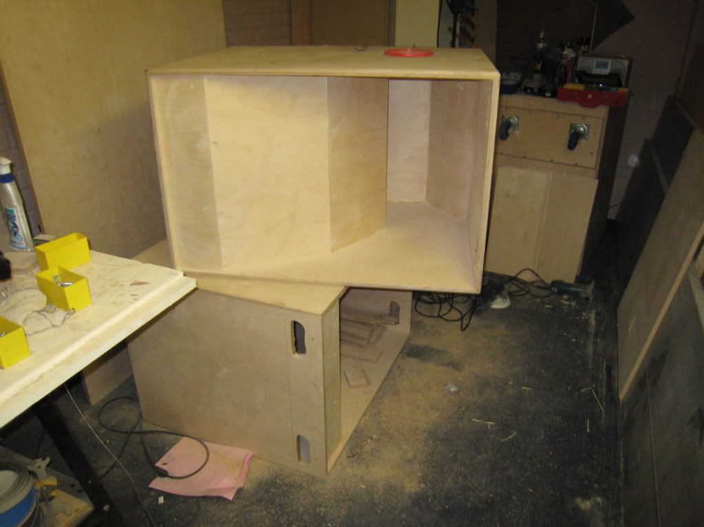

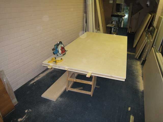

Post Options Post Options   Thanks (0) Thanks(0)   Quote Sinfinity Quote  Post ReplyReply Direct Link To This Post Posted: 17 October 2008 at 9:32am
young 1850's

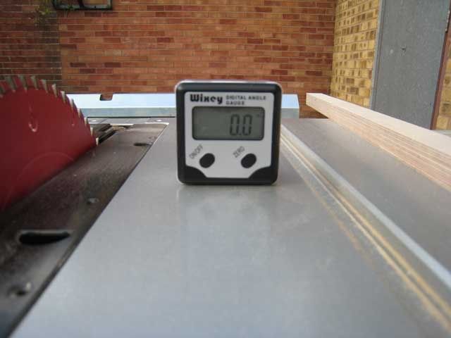

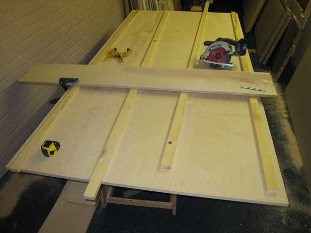

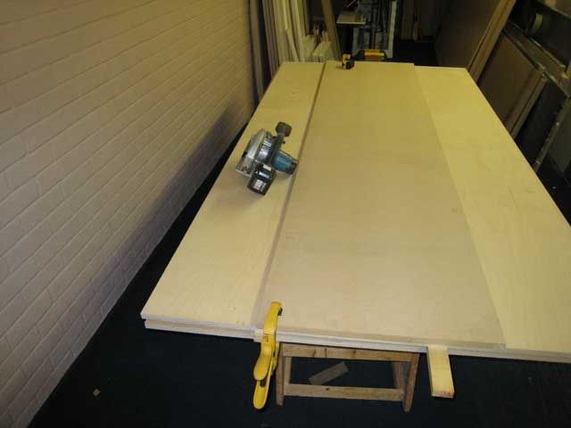

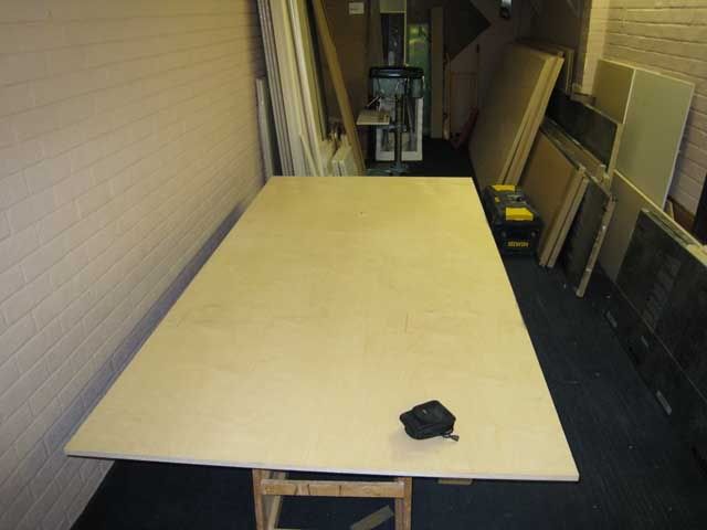

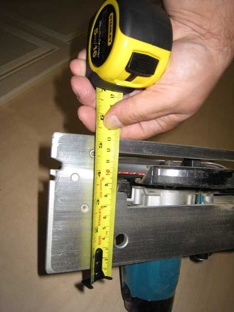

Post Options Post Options   Thanks (0) Thanks(0)   Quote Sinfinity Quote  Post ReplyReply Direct Link To This Post Posted: 17 October 2008 at 9:36am
checking saw offset and panel ripping. Working by myself so used small saw to get panels to size.

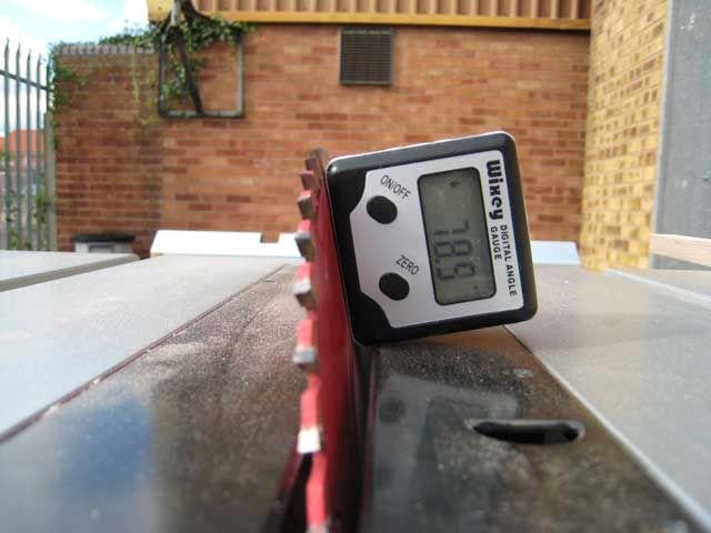

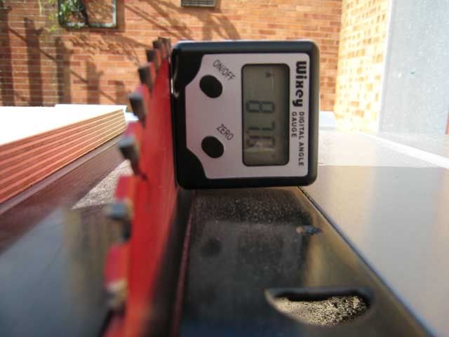

Post Options Post Options   Thanks (0) Thanks(0)   Quote Sinfinity Quote  Post ReplyReply Direct Link To This Post Posted: 17 October 2008 at 9:39am
Bevel cutting, handy little guage made angles more precise. Picked the guage up at a wordworking trade show to £20. Seen then for sale recently around £25 to £30

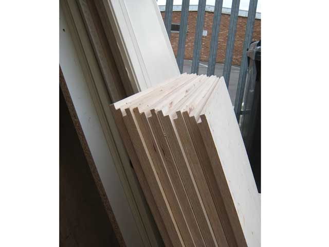

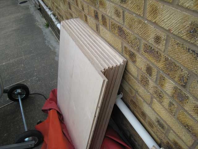

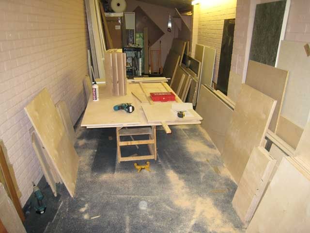

Post Options Post Options   Thanks (0) Thanks(0)   Quote Sinfinity Quote  Post ReplyReply Direct Link To This Post Posted: 17 October 2008 at 9:41am
Pile of panels getting bigger

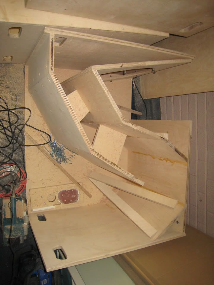

Post Options Post Options   Thanks (0) Thanks(0)   Quote Sinfinity Quote  Post ReplyReply Direct Link To This Post Posted: 17 October 2008 at 9:46am
Nice to have some space for assembly. Shame it was on carpet.
There is a bit of a jump after these shots, I forgot camera during assembly of first 1850, but will take pics of the second one.
I know my woodworking is by no means perfect, so feel free to point out errors and flaws.
Took a lot longer that i thought it would, but it was a very pleasant distraction from normal work.

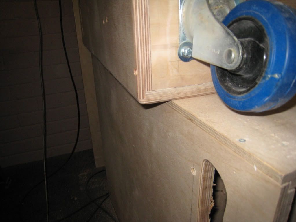

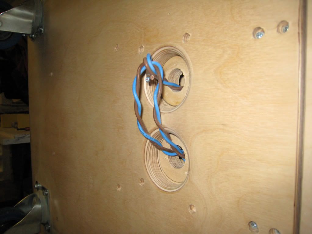

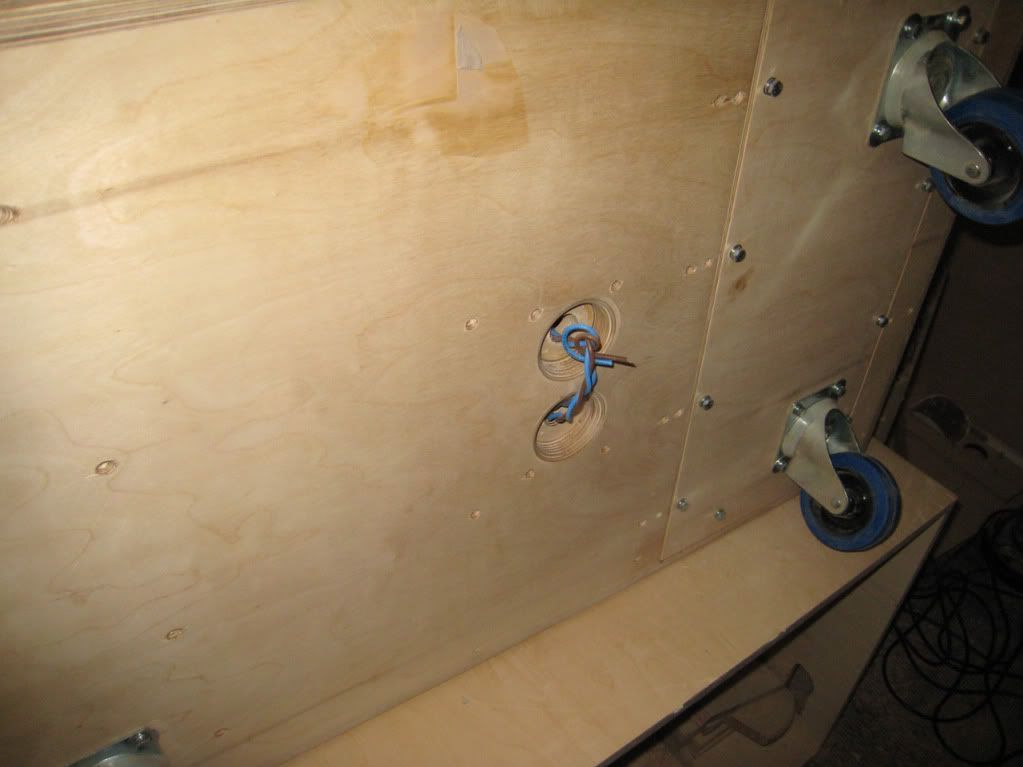

Post Options Post Options   Thanks (0) Thanks(0)   Quote Sinfinity Quote  Post ReplyReply Direct Link To This Post Posted: 23 July 2009 at 10:23pm
Updated pictures during build
