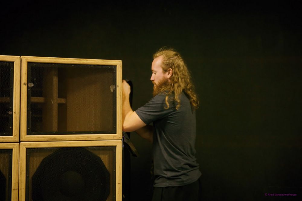

Curious as to why there are only photos of the racks/cases on the web site, presumably no actual loudspeaker cabinets exist to photograph.
These are some boxes from errr, 6, 7 year ago? They were built by Joseph / PCH Audio. Pictures are mine. These products/boxes should be on the website under the legacy/discontinued items.
Edited by HumbleDeer - 26 September 2025 at 10:58pm
