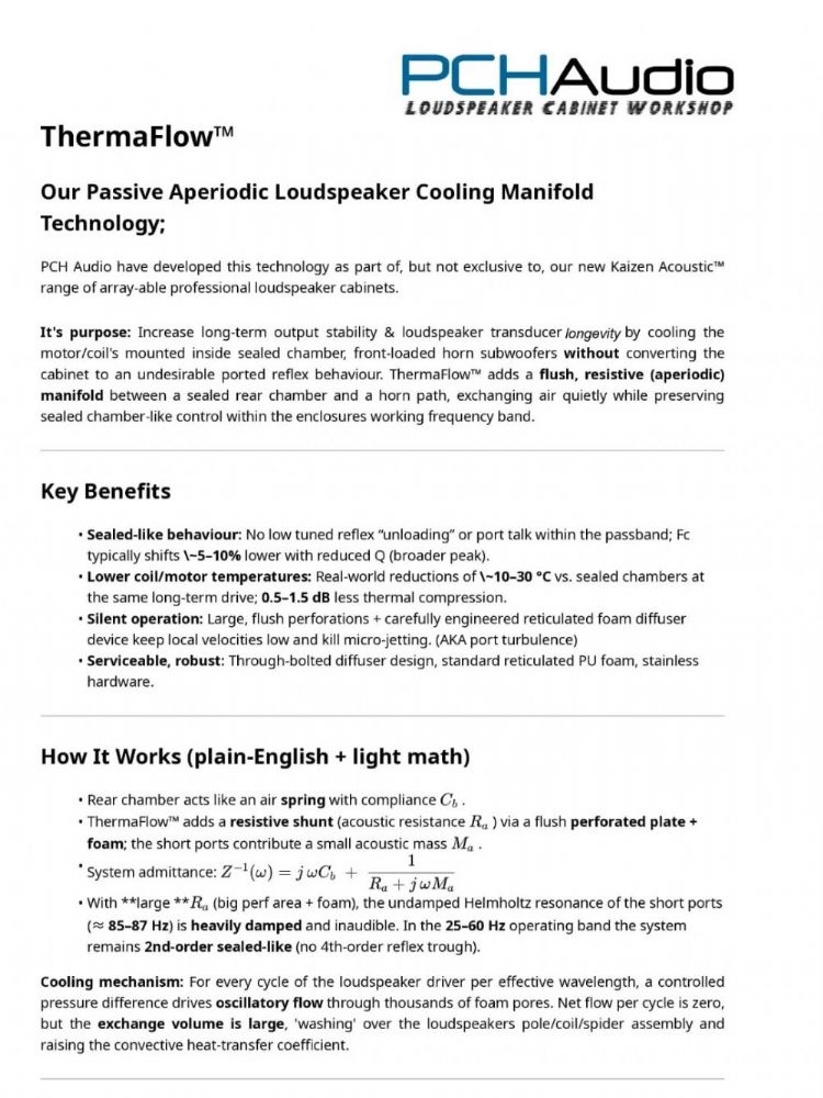

    Posted: 02 September 2025 at 3:44pm
what's this?

I would like to see a diagram of their system with heat flow.. because Im perhaps not understanding what they are suggesting is exchanging heat energy from the voice coil to the exterior of the cabinet ..using air "conduction" sounds massively inefficient to me.. why not use a heat pipe attached to the thermal mass of driver magnet to an external radiating surface.. or just design the cabinet with driver magnet not inside the box ..like many are anyway.

A spoof, wind up or April fool. Take your pick.

Their woodwork is exeptionally good. The technology mentioned is in the pattent approval process so no details publicly shown.
The entire design looks very interesting and i am sure it will work as advertised.

Exceptionally good woodwork is not that difficult if you have access to a CNC router; assuming you have reasonable CAD skills. Curious as to why there are only photos of the racks/cases on the web site, presumably no actual loudspeaker cabinets exist to photograph.
Quote The technology mentioned is in the pattent approval process so no details publicly shown
Do you have a link, or patent number? I’ve looked on the UK gov patent site and there is nothing listed. With regards the trade marks, Kaizen Acoustic turned up nothing and Thermaflow is registered but nothing to do with PCHAudio.
Quote The entire design looks very interesting and i am sure it will work as advertised.
I’m not sure whether a “woosh” is incoming, but from the description:
ThermaFlow adds a flush, resistive, (aperiodic) manifold between a sealed rear chamber and horn path.
Via a flush perforated plate + foam.
I assume that this is a snail style front loaded horn (similar to the punisher horn). A vent is cut in one of the rear chamber panels, and then covered with a perforated panel and sheet of foam. A foam covered perforated panel basically describes a typical grille. Hole size, layout and percentage of open area may be different but essentially a grille.
Here is a simple paint drawing for those having difficulty understanding. The red bit is the
passive aperiodic cooling manifold.
I look forward to independent tests proving that this is indeed capable of reducing the voice coil temperature up to 30ºC, but until then, if this is genuine, and not a spoof or just some AI generated drivel, my polite response is that I remain sceptical about its effectiveness.
