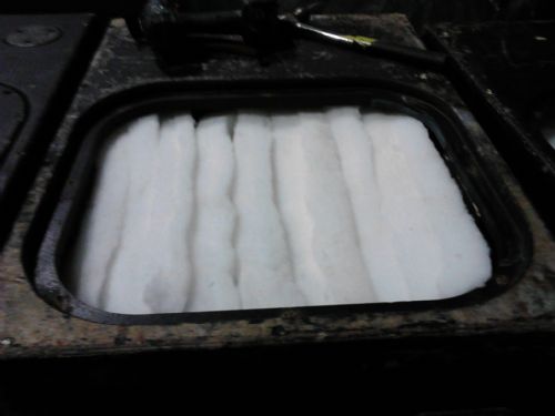

Anyone tried to open one of these?
The wadding in mine sits on top of the cone (driver sits with magnet in horn) seems a bit odd to me.
Two are rattling, don't see any other possible causes, could it be the cabling?

not sure what you mean by wadding sits on cone... can you take a picture...
sorry yes I see what you mean, yes that correct. wadding in rear chamber. I very much doubt the rattling is the cable, use a rubber hammer, and tap on braces ect to see if you can find out which one it is. Are you sure its not an air leak from driver hatch.... or speakon plate....

Thanx man!
Yup, wadding sits right on top of the cone.
Some was even sticking to the surround silicone:-(
Drivers had washers wider than the recession in the basket, could give a small leak, but the others are the same (guess i should change all).
I stripped up the cables, both drivers rattling where on the speakerwire side.
Problem seems to be solved, wadding still looks strange to me...
Should I fill the same into my other bph i wonder? -Could be dangerous as my 24 fane 18-1500 bph are front loaded and chamber could overheat. I tried turning them around, but they lost quite some sensitivity:-( Then I'd need a spacer ring to compensate for changed volume in front / rear chamber if I want to rearload them. Fane 18b600 sounds much better when rearloaded in my other bph, but not 18-1500, guess the 1500 prefers a smaller chamber than b600...

Woooow, that chamber is fully packed there.
