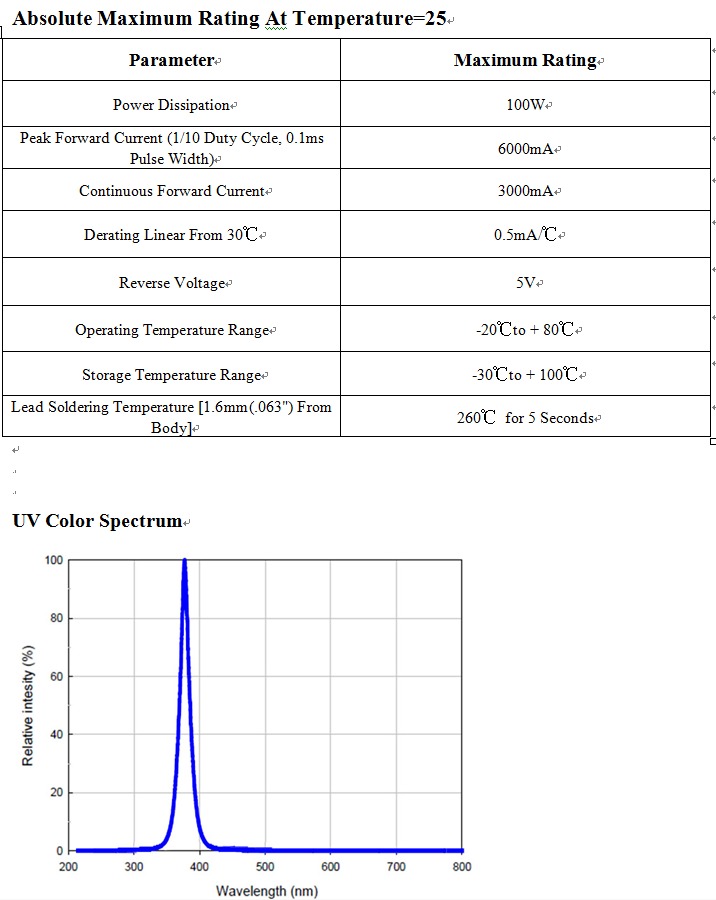

Edit: So, I just 'analysed' the published chart from the $200 LED I just linked to, the one rated at 365-370nm. The chart is only divided into 100's of nm but it didn't look like the peak was centered on 365 or 370. Turns out it's centered on 377nm.
This is what the light reproduction of a classic 400w UV bulb looks like:
Image result for uv cannon 400w wavelength
This is what you get with the LED, even the recent high powered lower wavelength ones (the ones you're looking at in the Cob cannons, almost certaianly)
So it's much more of a sharp peak than a scattered range (edit: that might be because it's a simulation rather than a measurement, but if the UV bulb cannon was shown as a simulation it would be focussed on 365 rather than 377. It seems likely that LEDs are more focussed in their range than metal halide bulbs but that's just speculation). By 365nm it's 23% intensity, but the 400w cannons are 90% intensity at 365nm, and they also reproduce a good dose of 340-360nm which is no doubt useful.
So I was a little hasty in my first analysis. The UV LEDs have still got a long way to go.

Edit: Here's another example of a COB LED that claims 365nm, https://th-led.en.alibaba.com/product/60444580173-800307320/Tianhui_High_Power_COB_UV_LED_Module_120W_365nm.html
Their published chart looks superficially as though it might be 365nm, but again on careful analysis (copy chart into Photoshop and zoom in), it's actually centred on 372.5nm.
I'm pretty sure they're all using the same chemistry and there's a hard limit they hit up against around 375nm, but they massage and misrepresent the data in every way they can to make it seem like 365nm, because they know that's the number people actually want. Again the issue of a much steeper roll-off than metal halide is apparent, down to 10% intensity by 360nm.
