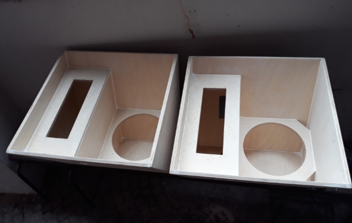

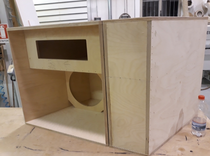

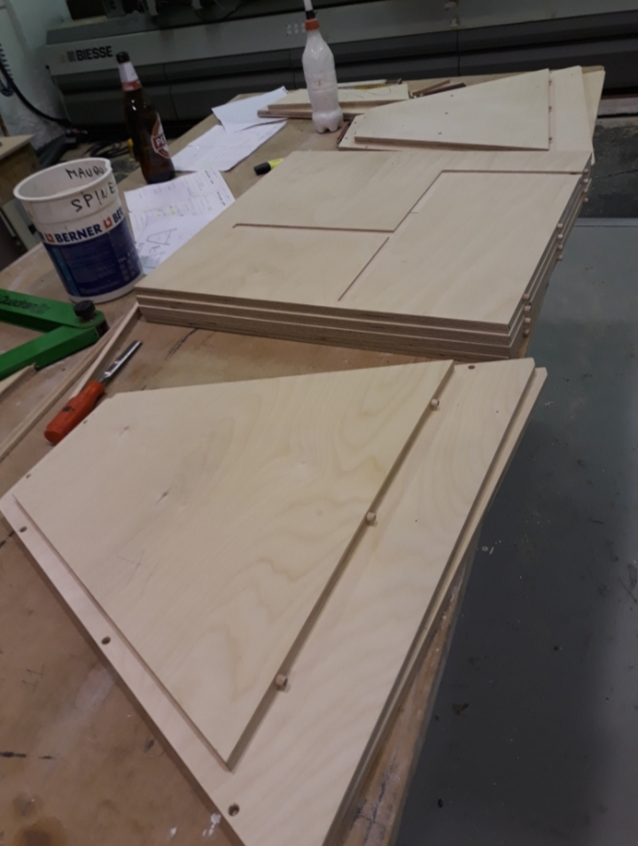

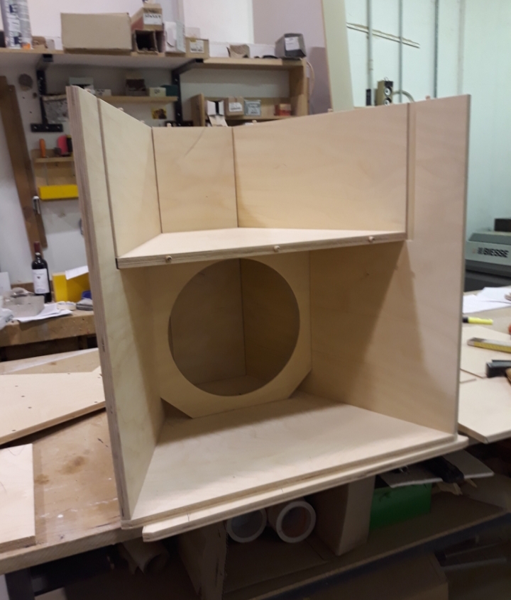

Hi everyone, i finally built my pair of single 12" SMTs. Still have to cut the holes for handles and connectors plate, which i'm going to do next week together with a good puttying and sanding job.. here are some pictures, as promised.
Cheers

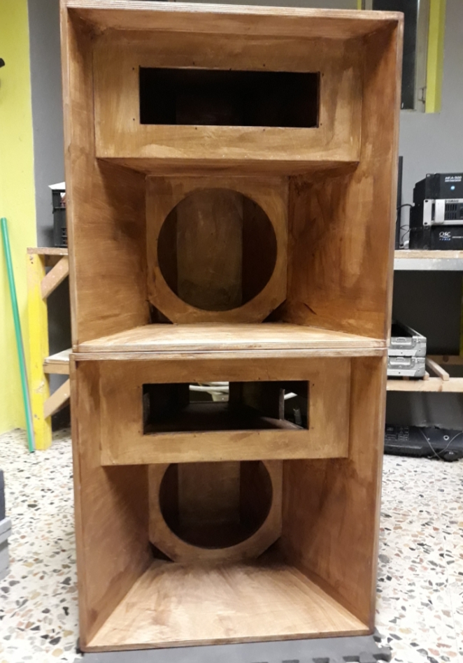

Post Options Post Options   Thanks (0) Thanks(0)   Quote sushi Quote  Post ReplyReply Direct Link To This Post Posted: 10 October 2019 at 9:42pm
During this last days i've cut the holes for handles and connector plates, done a puttying/sanding job, and painted the cabs with a wood impregnating agent.. soon i'm going to paint them with black poliurethanic paint (water based).

Brillaint work! How do you get the LF in/out? Can I just not see the access panel?
sushi View Drop Down
Joined: 27 March 2012
Location: Milan
Points: 95
Post Options Post Options   Thanks (0) Thanks(0)   Quote sushi Quote  Post ReplyReply Direct Link To This Post Posted: 11 October 2019 at 12:42pm
There's no access panel but the round cutout. It's a front loaded cab, if the size of panel A (in project) is correct, 12" woofer fits perfectly.

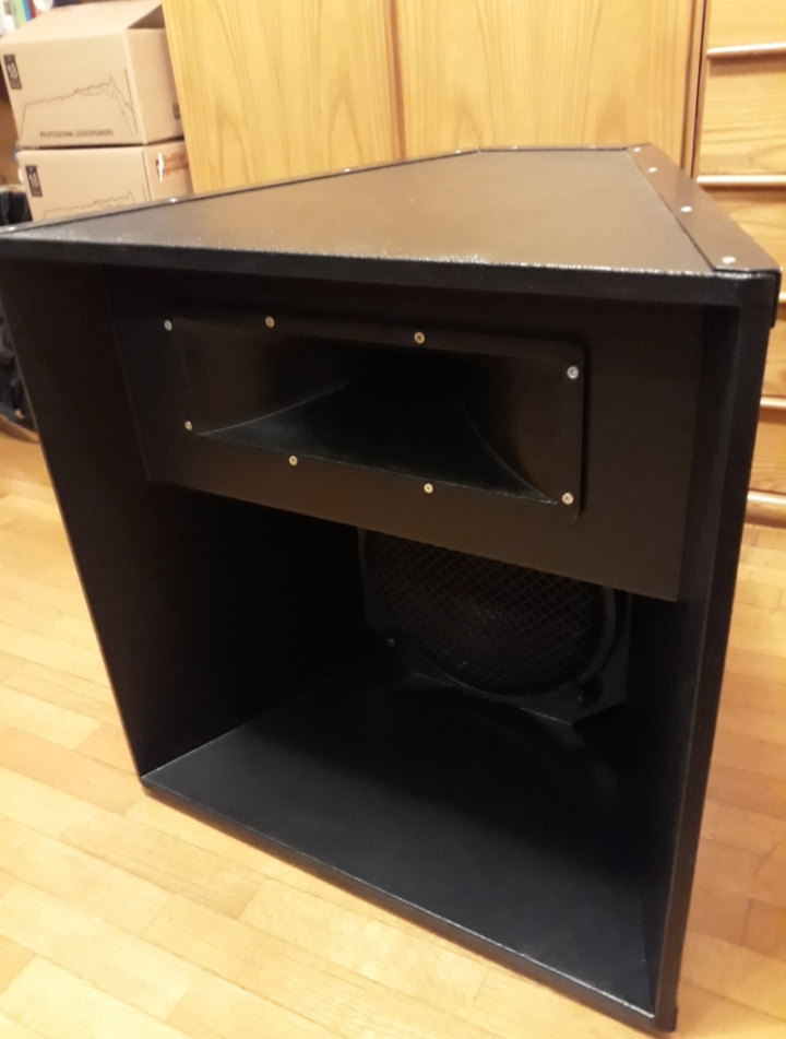

Hello everyone! I finished my pair of SMT112, and as promised i'm posting some pics.
I loaded them with Eighteensound 12ND610 and my spare hf drivers, placed passive crossover (filter at 2900hz) inside hf chamber, dampen lf chamber.. i tested them indoor (not at full power) and i really liked the sound, clear highs, punchy and loud mids, gets even lower than i thought.. not a kick bin however, so i'm gonna use them from 200hz more or less with hd15 under them. really looking forward to the next gig (30/11 in Milan, IT) to make them shout properly.
Oh, i tested them with Kappa12A as well: not bad i have to say.. but the 610 blows it away, even on lower frequencies.
I'm quite satisfied with this build, hope to see more progress and pics from FractureClinic, your 3way SMT project was dope mate.
