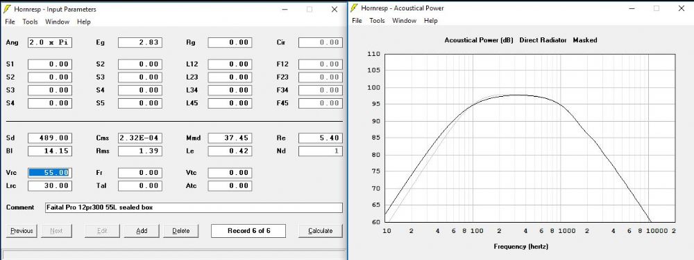

The Faital Pro 12 has a 3db roll off at 90hz in a 55 Litre box assuming that the box is sealed and not ported,
You could calculate the response using Hornresp. It now has a simple input box that allows you to enter the parameters easier. http://www.hornresp.net/ The screenshot shows the roll off in a 55litre box The grey line shows the same driver in half the volume 27.5L This gives more output above 90 Hz than the 55L This is why for a simple mid box often smaller is better. Edited by Xoc1 - 24 December 2017 at 8:42pm |
