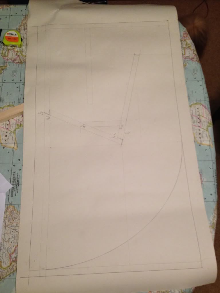

hello i started a thread asking for plans with no a massive about of feed but from what i have seen on the net small scoops are quit often used in hifi's so i found a plan for a 12"scoop and went for it not a clue if its going to sound any good but just building it for fun really so hear we go :)
This is the thread i stated off asking for plans
http://forum.speakerplans.com/ported-mid-horn_topic82893.html

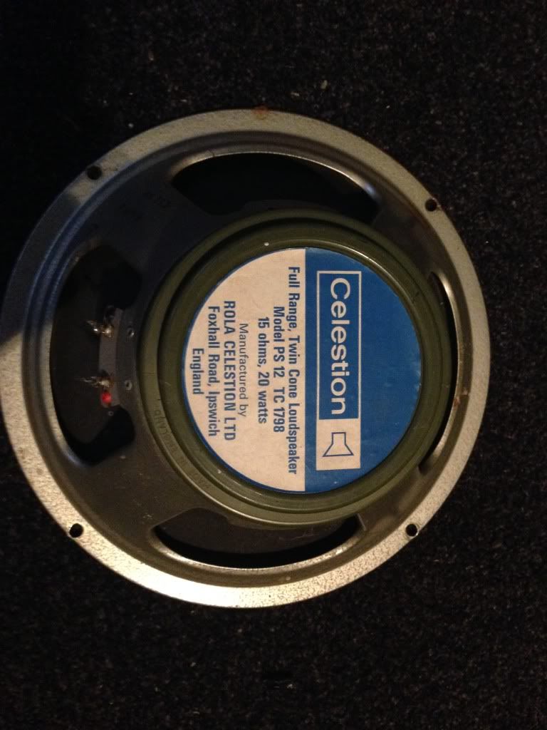

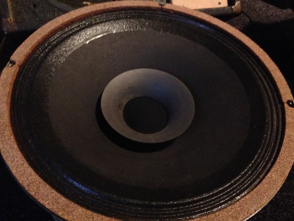

hears the spec so fair i managed to get 2 really nice sounding 12" drivers that will be powerd of a
2x30watt valve amp
celestion full range twin cone loudspeakers model ps 12 tc 1798
15ohms 20watts
the plan use shoure what its call the if any one could fill us in on that
the angels where missing so had to draw it to scale to find them out

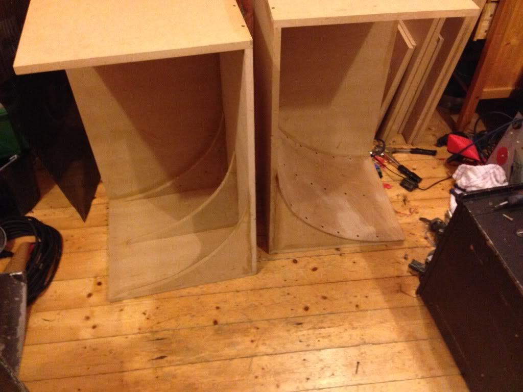

and this is where i have got to so fair :D my 1st scoop's

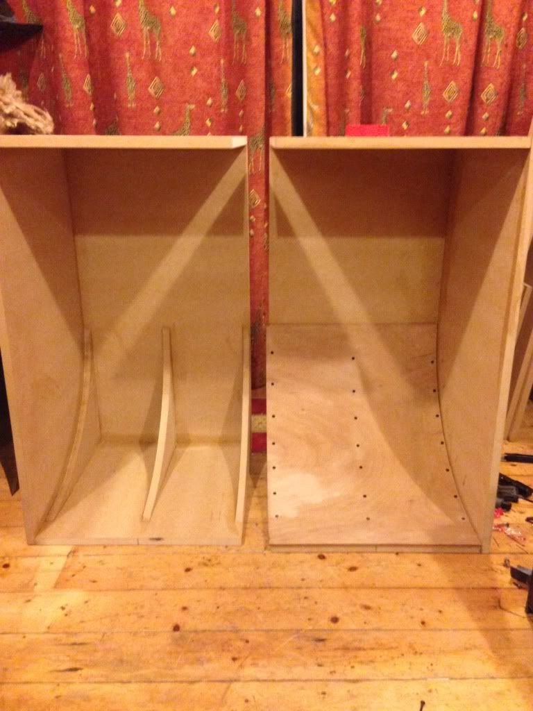

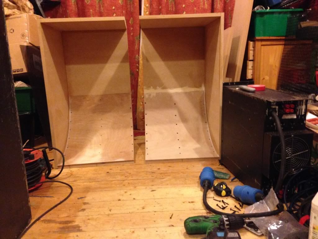

one last photo of where i am up to i am awaiting on boroing a saw to do the angels but should hopefully be testing them by the weekend fingers crossed
