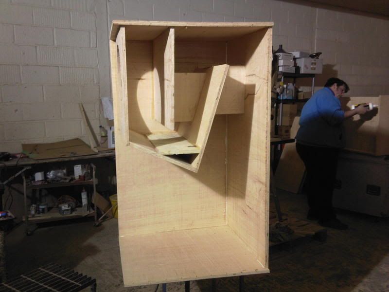

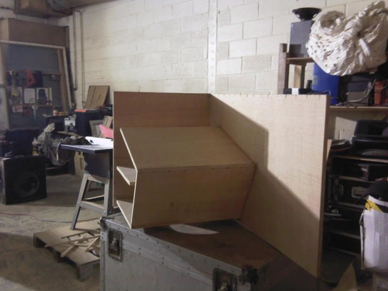

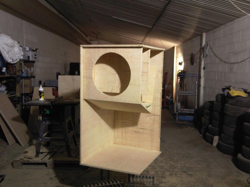

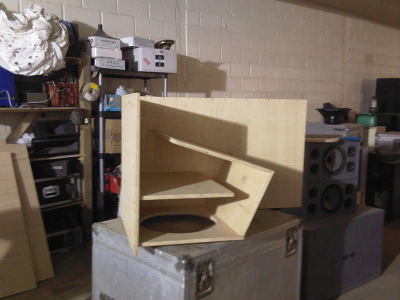

Post Options Post Options   Thanks (0) Thanks(0)   Quote Static Age Quote  Post ReplyReply Direct Link To This Post Posted: 23 November 2007 at 1:28pm
here are the pics..

Post Options Post Options   Thanks (0) Thanks(0)   Quote Tekasis Quote  Post ReplyReply Direct Link To This Post Posted: 23 November 2007 at 2:26pm
Looking good so far! Are you not planning to add the triangle piece at the bottom of the rear panel?

Post Options Post Options   Thanks (0) Thanks(0)   Quote Static Age Quote  Post ReplyReply Direct Link To This Post Posted: 23 November 2007 at 3:17pm
thanks, Tekasis.
which triangle piece are you reffering to, do you mean the panel immediateley behind the driver?
