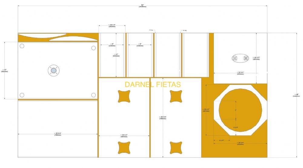

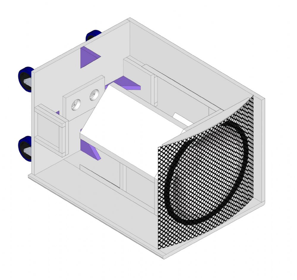

There are some good martin ws18x plans I have cutsheets for, if you are going that direction, I can post the rest. The b&c 18 plan doesn't have bracing but there's a 3d model of it, I think on speakerplans.eu. The 18sub the first one is actually even closer to your recommended volume/vas. Yea low end theory kind of got me into sound systems, I miss it dearly Smile  would go almost every Wednesday. Had a membership card. Good times.
