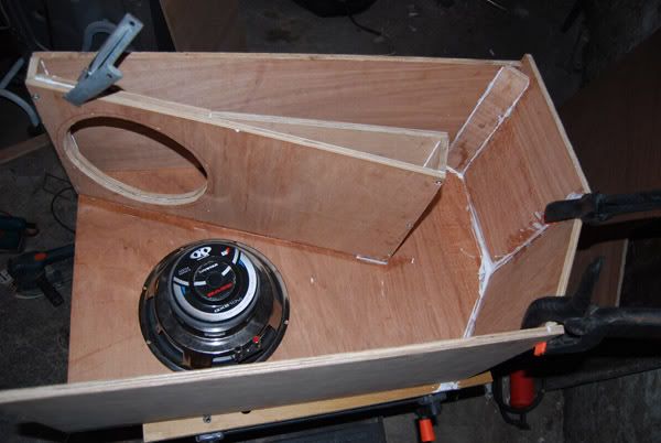

This is my only previous experience of speaker design. A 12v system. I had to fill the hole with sand! Not part of the new rig.... still sounding fat tho.
