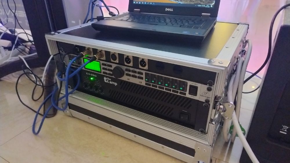

Yes the 112 sub + Montarbo AS is a small setup. I will try next time with a little bit powerful amplifier on the subwoofers! Thanks for all the advices.
For the DCX2426 settings like limter and maybe highpass? HP 37 Hz 24 db/oct is ok?

I think that the t.amp E4-250 is lacking some power to the subs...

Well, Thomann say 40Hz for the cab, so you should set the HP there.   Smile

Just pulled the rig out and fired it up, I run the 112’s 40hz LR24 up to 200hz LR24 , with my Sherman R2m’s overlapping 125hz LR24 up to out, but at -4db to the subs. Cracking little system, the size and weight of the subs make even upstairs rooms in venues really easy.

Which amplifier are you using?

The t amp E4-250, same as you. Crossover is a BSS 336T minidrive.
