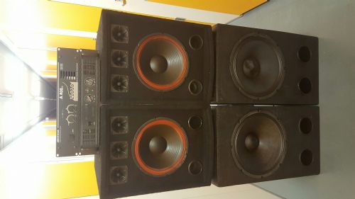

This was mine from about 1996 onwards... the bass bins are repurposed big reds. Stripped the carpet off and stuck a new baffle on with dual 4in ports and a 15" jobbie. The tops WERE just straight wired piezo and 12" driver til i stuck in a crossover and now they sound a billion times better!. Dont get me wrong, she may look a bit ugly but she does kick out a good sound and have played a number of house parties with many complaits..... from people on the same street! Lol.
But sadly.... now i need the room back in my lock up so she has to go.
.... stupid sideways picture!

We're the complaints about the sound quality :P

lol... no... i have managed to get it to sound quite good. Padded the piezos a little and cut the 12 at 3.5k to meet them. The bins take over around 130-140ish and wen wacked up can sound quite good.
not the worlds best rig, but it does work well!
