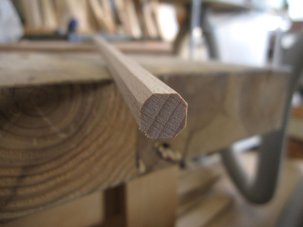

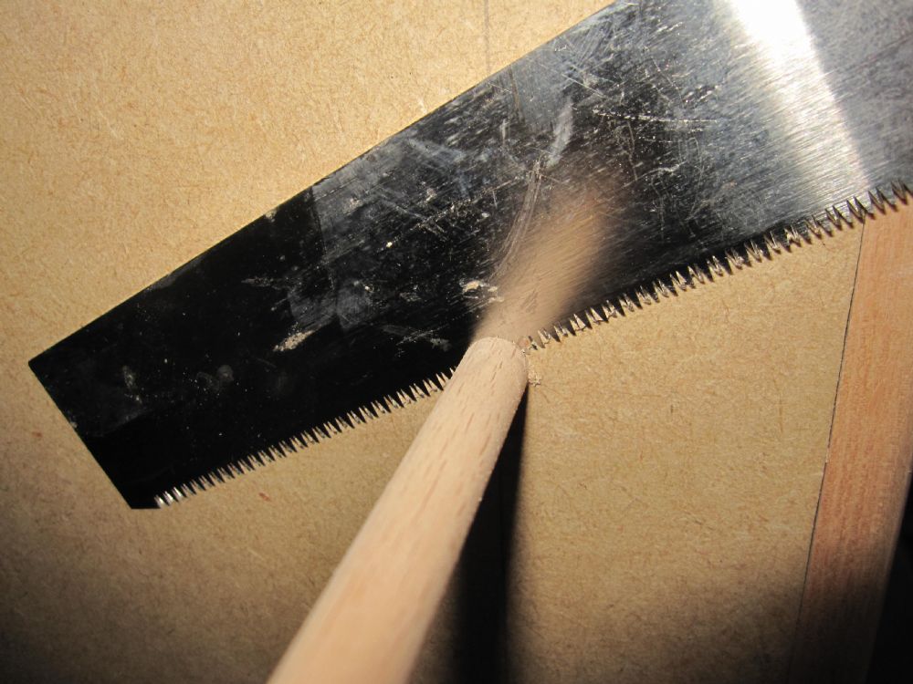

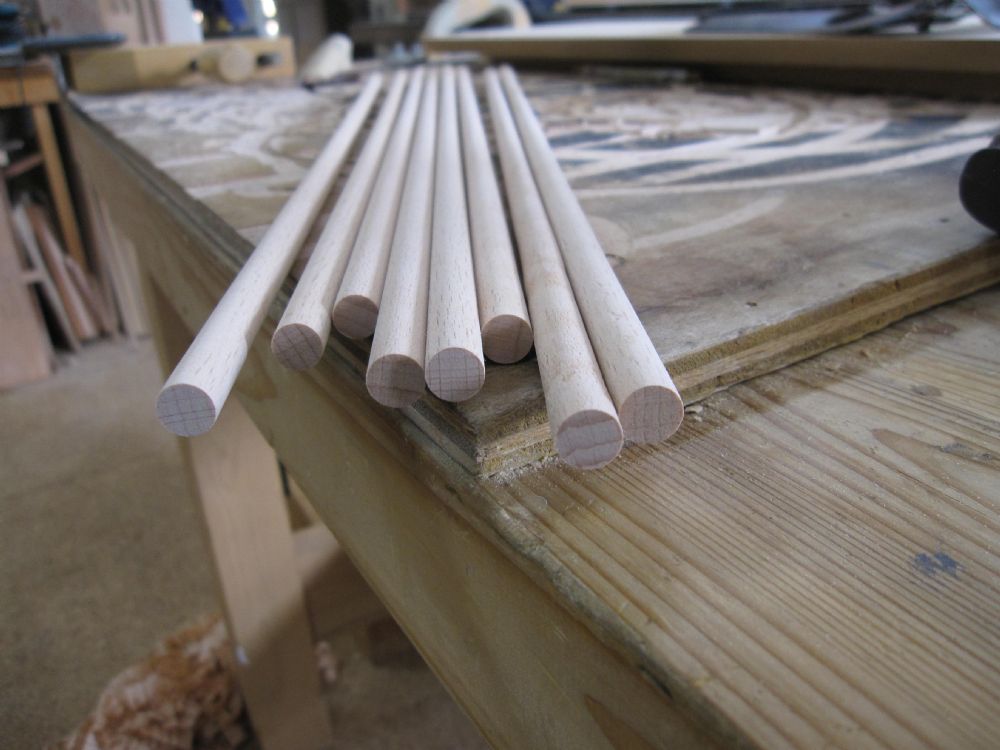

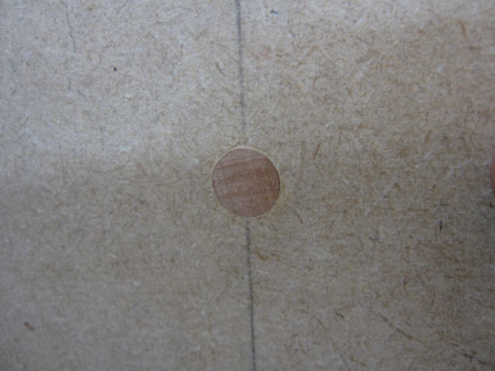

So, made the beech dowel to fill the screw holes. May be of interest to somebody. One time walk away sand once. Makes sense to me.

Your build is tidy though, and they look great! Loving the dowels.

Bob they are nice saws that one is a flush trim 'kuggihiki' so the teeth have no set. I must admit that I had real trouble with them at first. Now I really get it and love them. The double one is called a 'ryoba' rip and cross cut. Watch the teeth they are very brittle. The other one is maybe a 'dozuki'.
